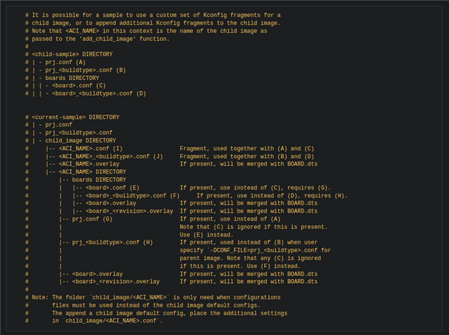

    I need to find some way that I can apply a kconfig overlay for specific child images.  I would like to have multiple builds with different config overlays that add specific features.
    Please do let me know if you have any recommendations.
    From Multi-image builds:
    Specifically:
        #     |-- <ACI_NAME>_<buildtype>.conf (J)     Fragment, used together with (B) and (D)

    Keep in mind that if you remove the default "prj.conf", it will increase the complexity of the build setup, so you should probably include instructions on how to set up a build for your project in a README or something. (I have received customer projects which I struggled to build due to them using build types)
