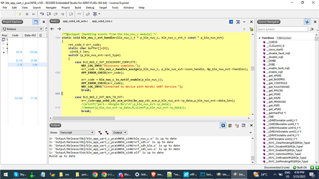

Is there any possible way to sedn the data from peripheral device(nrf52832 dev kit) to nrf52840 dongle which is connected to Bluetooth-less desktop
In my project, i want to send the data from the ble device nrf52832 dev kit to the nrf52840 dongle which is connected to a Bluetooth-less desktop. Some desktop doesn't have inbuilt Bluetooth and for that, i used an nrf52840 dongle with the help of nrf connect desktop app i flashed the dongle(here i don't have any example or source file, firmware flashed directly by the app), and when I connect it to desktop & scan the peripheral devices with Bluetooth low energy option in nrf connect app. even I can connect the peripheral devices.
Now the issue is how can I send the data from the nrf52832 dev kit to nrf dongle because there is no source file I couldn't add code to receive the data. i tried ble_app_blinky and ble_app_blinky_c examples to send the button state data from peripheral to central so can i use the same for nrf52832 and dongle.??
if so, using the dongle can we connect it to PC and send the data to pc.??
please let me know how can i implement this.
Thank You.

    Thanks for the reply,
    After you followed the documentation and can forward UART data from one PC to another PC (or from a phone to the PC), you can write your own application to read the UART data instead of using a UART terminal.
    Regarding this point, I have experienced the ble_app_uart example and i can able to send the data from hw uart and receive it in the dev kit  and push the same data to the mobile app. This is what the example code would do. but i don't have any idea about ble_app_uart_c.
    After that you can star the next step to either make your own PCB to make a dongle or use nordic dongle and use USB instead of UART. But that should be the next step.
    Already I have my custom dongle pcb board and i tried the usbd_cdc_acm example to send the data from the terminal to the dongle and it's working fine.
    still a lot of effort I don't know which example is suitable for a dongle board since the firmware is flashed via nrf connect app.
    Regarding pc_ble_driver I have seen this before only but it's really confusing and I don't know to kick-start this. please help me step by step then it will very easy to get into that.
    Please help me.

    I have already tried this also with a tp-link Bluetooth adapter and its works fine but I want to make it with nr dongle custom board.
    I tried to add the usbd_hid_composite example to the merged one (ble_app_uart_c +usbd_ble_uart) so we can achieve this right.?
    And also can't able to add nrf_nvic.c and nrf_soc.c files.
    Thank You
  • I'm afraid that we won't be able to provide more help on this as it's more of application development that you need to do. Please try to check and debug why you can't send more than 6 characters.
    i can able to send the data continuously by doing like this,
        ret_code_t ret;
        static const app_usbd_config_t usbd_config = {

    afte this i started to add the code for ble_app_uart_c but  after adding this the first time I got
    nrf_drv_clock_init() return ERROR 133 [NRF_ERROR_MODULE_ALREADY_INITIALIZED]
     then I commented out nrf_drv_clock_init() because maybe in a soft device its initialized and i checked that with
    ret = nrf_drv_clock_init_check();
    NRF_LOG_INFO("ret:%d\r\n",ret);
     it returns 1 so it is initialized then after commenting out no errors but I couldn't send the data to Notepad.
    what will be the problem.?
