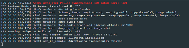

But mcuboot never accesses the secondary slot to perform the swap. Leaving the slot as always pending.
mcuboot log
