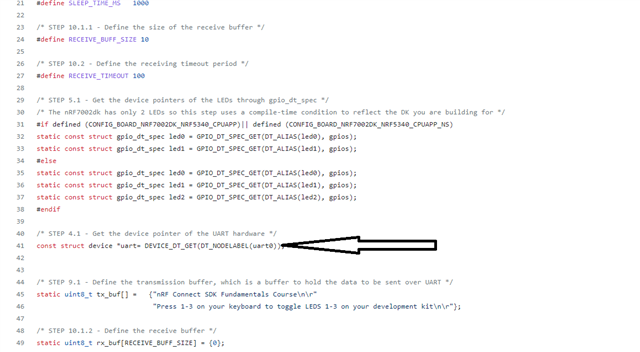

code flashed in nrf52840 dk board but not executing its task for any code
i am using vs code for programing and flashing the code.
I have previously run all led blinking code, printing code in serial monitor  given by nordic academy then board inbuilt led`s were blinking and successfully printing on com port as per code written. the last code i performed in nrf52840 dk board successfully was uart communication code (https://github.com/NordicDeveloperAcademy/ncs-fund/blob/main/v2.x.x/lesson5/fund_less5_exer1_solution/src/main.c) for that the physical connection was:-
nrf52840 dk        USB_to_serial
po.06                   RX
po.08                   TX
Po.00                   GND
As nrf52840 dk has two uart interface uart0 and uart1 that`s why i just wanted to check that uart1 is also working or not so to do that i just replaced uart1 in place of uart0. for referance i have attached below image also.
and  flashed the program in board but led`s were not blinking on sending 0,1,2,3from uart interface (USB_to_serial interface).
[ here i have done one wrong thing that i didn`t change the physical pin connection for uart1]
to confirm that is there any thing wrong with that code , i ran the simple led blinking code ( which was from nordic academy ) but nothing was happening .
so i uploaded other sample code but in response nothing was happening.
so the problem is that code is uploading successfully but not executing . i don`t  why this happening , is it stuck in any mode.
( link for code which i used all of them were fro here https://github.com/NordicDeveloperAcademy/ncs-fund/tree/main/v2.x.x).

    You need nRF52840dk_nrf52840.overlay to overwrite the device tree to use uart1:

    Here is my test project fund_less5_exer1_solution_uart1.7z for NCS v2.3.0.
    Beware that this code/configuration is not fully tested or qualified and should be considered provided “as-is”. Please test it with your application and let me know if you find any issues.

    My problem is solved and now my 52840 dk board working properly. Actually there was problem of pin conflict so i just deleted installed toolchain and sdk 2.3.0 files and again installed everything from nrf connect for desktop.
