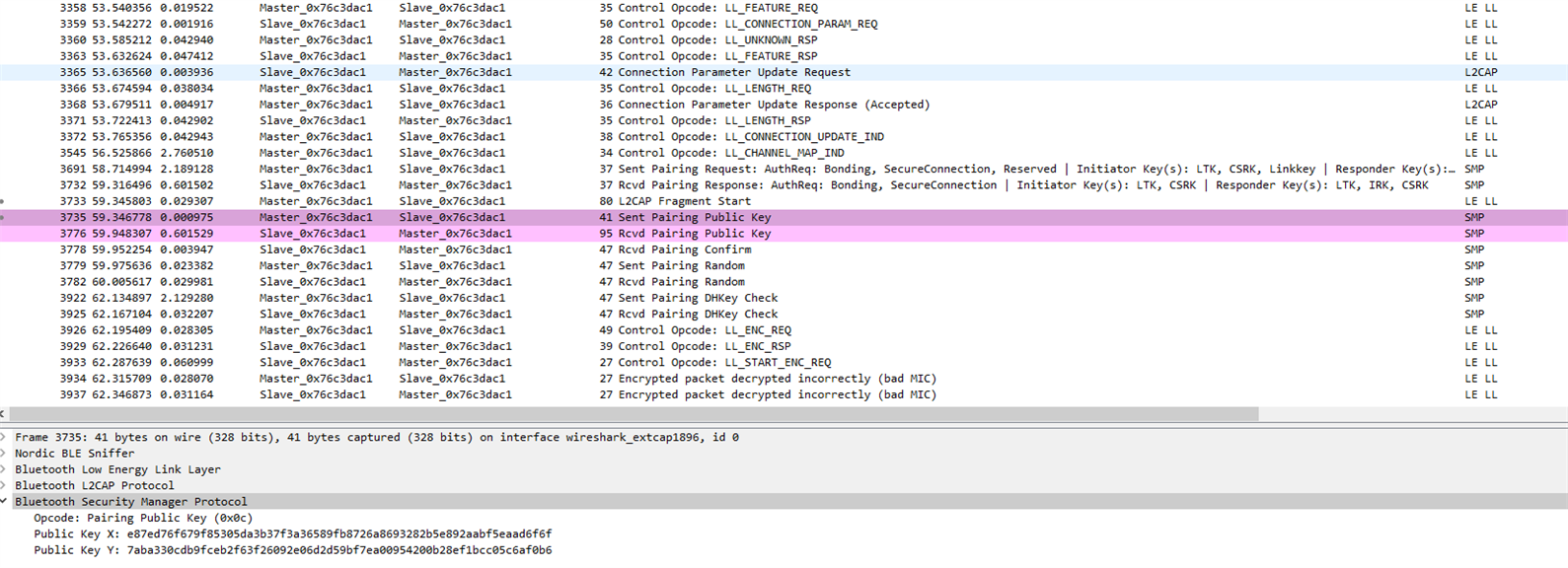

  • Issue - I am trying to pair the slave device with the RPi using LE Secure connection, but I want to use the default debug keys defined by the Bluetooth core spec which I have set by using btmgmt command and triggered pairing/ bonding using bluetoothctl. But in wireshark logs I can see the data packets are Encrypted, which means debug keys are not correctly used, even though spec says, only one side needs to set the debug mode/ keys.
Detailed description - Here are the steps I followed
  1. nrf52840 dongle is connected and wireshark is collecting logs

  7. As seen into the above logs, Pairing request/ response are seen, keys are exchanged and encryption is started and we cant decrypt the packets

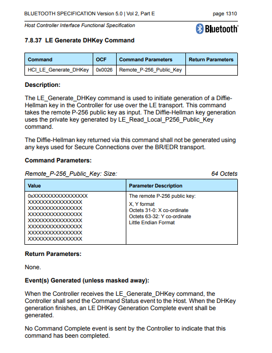

Moreover I also tried to set this keys using LE Generate DHKey Command, but still cant decrypt the wireshark logs
