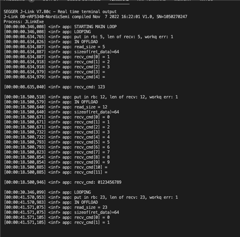

This is probably just me not knowing what I'm doing, but I could really use some help. I am trying to set up two UARTs on the nRF52840. We have a custom board but I am starting with the DK. I have gotten both UART0 and UART1 to work simultaneously, while using RTT to verify that things were coming in. However, I need to manipulate the data coming into the RX buffers before sending it out. I'm having trouble:
-Getting UART data in large packets (the async callback seems to break up larger packets into multiple callbacks)
-Using a workqueue to effectively offload computing
-USING THE RINGBUFFER!!! I think a big part of my issue is that the head/tail is getting off or I'm not doing it right or something.
-When recieving larger test messages, such as "123456789012345678901234567890", I lose bytes or sometimes it gets outright truncated. After this, my program seems to be "off" or "shifted" as if the ringbuffer head or tail is off.
-using "uart_tx" with a string. I have converted the rx input (when it works) to a string (char array) but when I test out just sending it back with uart_tx it fails. I have tried typecasting into uint8_t* and lots of other things. I just can't get it to work.
I would also just love for someone to explain a little more about how to best receive UART data effectively. Things like best practices, etc. A code snippet would really help me.
Test setup:
nRF52840 DK plugged into my mac. There is also a uart/usb bridge plugged into P0.11 and P0.12 which I changed to UART0 in the device tree overlay. I use this to talk to the UART0 device. I am ignoring UART1 while I figure out how to accurately get messages from UART0. I am using RTT for my LOG messages, displayed on RTT-viewer or in VSC.
NCS 2.2.0
In my code I put some LOG_INF stuff. I included some screenshots of some basic tests. You can see that smaller tests from the serial terminal like "0123456789" are fine. But "01234567890123456789" will go freeze the program. This is with a uart_rx timeout of 1000 ms. I'm assuming I would want something more like 10-100ms. When I set uart_rx to 100ms it will freeze with just "0123456789" or even smaller.
main.c

		LOG_INF("read_size = %d", read_size);
		LOG_INF("sizeof(ret_data)=%d", sizeof(ret_data));
		for (i = 0 ; i < read_size ; i++) {
			LOG_INF("recv_cmd[%d] = %c", i, ret_worker[i]);
			recv_cmd[i] = ret_worker[i];
	LOG_INF("recv_cmd: %s", recv_cmd);

			int len = ring_buf_put(&rb0, (uint8_t *)(evt->data.rx.buf + evt->data.rx.offset), evt->data.rx.len);
			k_mutex_unlock(&ring_buf0);
			int err = k_work_submit_to_queue(&uart0_work_q, &uart0_work_info.work);
			LOG_INF("%d, %d, %d",len, evt->data.rx.len, err);

	err = setup(); //setup the GPIOs and uart device
	if (err == 1) {
		return 1;
	//ENABLE/CONFIGURE UART0
	//assign the settings found in the settings structure for uart
	if (uart_configure(uart0, &uart0_cfg) == -ENOSYS) {
		return -ENOSYS;
	//assign the callback function to the uart device
	err = uart_callback_set(uart0, uart0_cb, NULL);
	if (err) {
		return err;
	//enable rx, and assign a buffer
	uart_rx_enable(uart0, rx_buf0, sizeof rx_buf0, UART_TIMEOUT);
	//ENABLE/CONFIGURE UART1
	if (uart_configure(uart1, &uart1_cfg) == -ENOSYS) {
		return -ENOSYS;
	err = uart_callback_set(uart1, uart1_cb, NULL);
	if (err) {
		return err;
	uart_rx_enable(uart1, rx_buf1, sizeof rx_buf1, UART_TIMEOUT);
	//ring_buf_test(); //just me messing around
	k_work_queue_start(&uart0_work_q, uart0_workq_stack_area,
                   K_THREAD_STACK_SIZEOF(uart0_workq_stack_area), WORKQ_PRIORITY,
                   NULL);
	strcpy(uart0_work_info.name, "Thread0 emulate_work()");
	k_work_init(&uart0_work_info.work, uart0_offload_func);
	//start the main loop.
	LOG_INF("STARTING MAIN LOOP");
	while (1) {
		LOG_INF("LOOPING"); //prints over RTT. Connect via usb and view with RTT viewer (there is one built into vscode)
		// you can use the built in RTT viewer by clicking the plug shaped icon next to "RTT" under "CONNECTED DEVICES"
		// on the side tab on the bottom left.
		err = uart_tx(uart0, tx_buf0, sizeof(tx_buf0), SYS_FOREVER_US); //prints on uart0. I set TX to P0.11 and RX to P0.12 using an overlay
		// I had to move the uart pins because P0.6 and P0.8 (the default uart0) are inherently stuck to the console on the DK???
		if (err) {
			return err;
		err = uart_tx(uart1, tx_buf1, sizeof(tx_buf1), SYS_FOREVER_US); // uart1, TX RX set to P1.01 and P1.02
		if (err) {
			return err;
		k_msleep(30000); //sleep for 30 second

serial terminal
RTT-output
    I think this for most part is "just" something you need to work through. The first I would have looked at is examples and driver test projects that use uart, but also check the documentation. For instance you are not feeding a buffer as recommended:
    https://developer.nordicsemi.com/nRF_Connect_SDK/doc/latest/zephyr/hardware/peripherals/uart.html#c.uart_event_type.UART_RX_BUF_REQUEST
    Here is description of handling of events:
    Kenneth
  • For anyone with a similar issue, I found that working through the linked github example made UART work a LOT better and helped me to understand it better. In a nutshell:
    - Double buffering is important! don't leave it out!
    - You don't have to understand double buffering to implement it, as shown in the linked example it's just a single line of code in the UART callback, and a few lines of setting up the buffer at the top of the file.
    - Message queues are important too! Those are worth understanding a bit more. I don't think they are required, but they work really well in tandem with async UART, and thats what the linked example uses.
    - The linked example prints everything right away, but if you want the data in memory so you can perform operations on it you can start a thread that checks the message queue for new messages using the "k_msgq_get(...)" function. If this function returns true, it means that there is uart data ready to save to memory and you just save it and repeat basically. I added a basic snippet that I use (I modified the snippet from what we exactly use for intellectual property reasons, code may/maynot be broken but it should at least work as a starting point).
    https://github.com/too1/ncs-uart-async-count-rx

  •  - awesome! This is exactly what I've been trying to understand how to do, having stumbled across the same Github example.  You've saved me heaps of time/hassle.
    Not sure I fully understand what I'm doing, but I've got something working and so now I can play around with it and make sure I do
    Cheers,
    Mike
