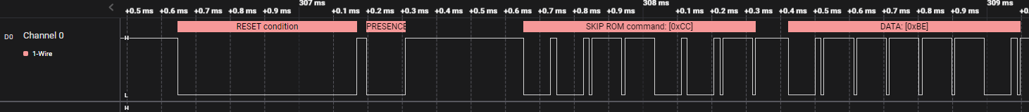

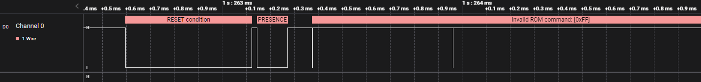

I'm working with Raytac MDBT50Q-DB-40 dev board, which is hosted by an nrf52840. SDK is latest nrf Connect/Zephyr version (2.3.0) running under Visual Studio Code on an Ubuntu personal computer. The (peripheral_uart) NUS example works just fine standalone.  I'm actually using the NUS example and modifying it and the original nrf52840DK device tree  for my project's needs. The DS18B20 1-wire example works just fine standalone.  The PWM (blinky_pwm example) works just fine standalone.  I have a modified PWM thread based on the blinky_pwm example working inside of NUS. The unmodified DS18B20 thread is not working within the NUS application as a thread or with it's code running in the main function. I traced the 1-wire thread's 1-wire protocol data stream with a Saleae Logic analyzer that supports 1-wire protocol translation. The 1-wire skip rom command following the presence pulse is getting corrupted and thus temperature readings are not taken and all output defaults to 0.0000 as  the temp array elements are most likely initialized to zero.

Here's a screen shot of a corrupted 1-wire sequence running as a thread inside of the NUS example app.
Here's a screen shot of a good 1-wire sequence running standalone.  Exact same 1-wire code that will not run within the NUS example app.
