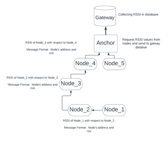

i am using nrf connect extension in vs code with Zephyr OS build v3.2.99-ncs2 and Nrf connect SDK 2.3.0. Our Application requirement to make Mesh Network. In which Anchor, Node and gateway are placed to cover 2 rooms.
could you please suggest me any example code and tutorials on this given diagram?

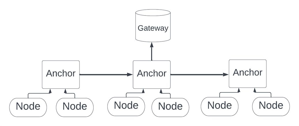

    Anchors are stationary wall mounted device operated on 3v-CR2032 Cell. nodes are also battery operated device. our application requirement to build mesh network of nodes to cover a range of room. each node sends their rssi value to the anchor. anchor collects the rssi value and send to the gateway. anchors would be in range to each other. Node relay rssi and address to the anchor periodically.
    What's the distance between the Anchors ? And the distance between Gateway and Anchor. Would all the anchors be in the range of the Gateway ?
    Distance between the Anchors: 15 - 20 meters. Distance between Gateway and Anchor : 10 - 15 meters. not all Anchors are in range of gateway. actually gateway has power source to run on full receive mode. we want what is standard range of ble devices. low energy max distance possible.
    Have you tried with our mesh sample in the SDK for example \nrf\samples\bluetooth\mesh\light and \nrf\samples\bluetooth\mesh\light_switch ?
    yes, currently using mesh example and provision them by nrf mesh network app. issue is that received rssi value is not of original sender. ow relay the rssi data? could please enlighten me on this? could not able to find meaningful tutorials and demo examples.

    There isn't a RSSI model example on nRF Connect SDK. However, you can have a look at our concept and implementation in nRF5 SDK (legacy SDK , no longer in development) https://infocenter.nordicsemi.com/topic/com.nordic.infocenter.meshsdk.v5.0.0/md_models_vendor_rssi_monitor_doc_rssi_model.html?cp=9_2_2_4_5_2_0
    The idea is that it collect the RSSI value of any mesh packet arrives. Then store it in a database. The client then can request that database from the server.
    starkAbhi said:
    how each nodes after provision know the address of anchor to send specifically their rssi to anchor only?
    The Anchor should request the RSSI database of the node. It can be that the only gateway can collect the RSSI value of each node in the whole network.
    I would suggest to get familiar with the mesh set up and how you can use the standard model, before you start implementing your RSSI model.

    did you mean Gateway request anchors for rssi of individual nodes. gateway(client-request rssi)->anchor(client-database rssi)(server-rssi)->nodes(server-rssi).?
    or i am confused?

  • Hi Abhishek,
    As I mentioned, please get familiar with the mesh source code, try testing with the sample, how you can use model etc before moving to the real application of using rssi.
    You can run the rssi client on the gateway and then collect the rssi data of each of the node, In this case you collect data from Node 2, to see the RSSI between Node 1 and Node2. Then you collect data from Node 3 to see RSSI between Node 2 and Node 3.
    The Anchor only a relay device, it doesn't need to know anything about the nodes around it or which node is connected to it.
    You can choose to do your own implementation, you can choose to have a database on the Anchor, but it's your design choice. We provide you the mesh network. The application, and how you design it is up to you.
