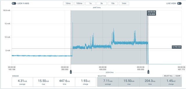

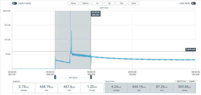

    Unfortunately, i am unable to get logs from device, as when we power the module from debugger, the power doesn't get cut off. The power cuts off only when module is powered through a battery. And that's why is it becoming difficult to debug this problem. Can you recommend me a way to get logs from the module?
  • In that case, it is difficult to say what power consumption that is drawn by the nRF. You would need to run it on a separate device (perhaps a DK), and compare the current consumption with your two approaches.

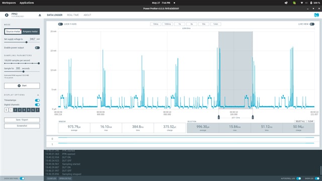

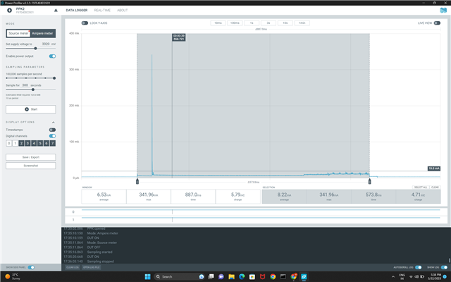

  • Hey, i checked it with a DK, Power consumption is very low, i can see 996uA current, I've set publish interval to be 50msecs.
  • That looks more correct. It looks like you still have an offset.
    For current measurement purposes, try to disable the UART (typically used for logging). Add CONFIG_SERIAL=n in your prj.conf.
    This is what I see with a 50ms advertising interval:
