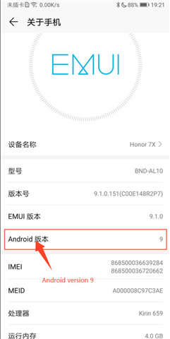

  • Hi
    For the test video, the android version is 9, and the nRF Connect version is 4.26.0
  • The test video for the Apollo BLE
    Thank you for the videos. Which exact phone are you using?
    As mentioned I have not been able to reproduce this on my end, but I have forwarded it to our app developers so that they can have a look.
    For the test video, the phone is Honor 7X.
    And I tested two Samsung phones, which automatically re-searched Bluetooth when they turned on Bluetooth, and did not reproduce the issure.
