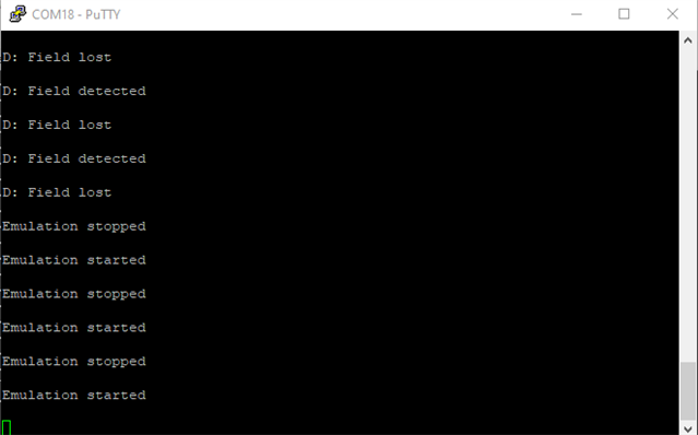

I am trying to develop an application where I can turn on/off the NFC T4T tag emulation using interrupt-driven buttons.
However, after the first read of the NFC tag, only NFC callback events can be run, while blocking any other code to run(Including button interrupts, and logging).
I couldn't solve the issue by myself, and I would appreciate it if you can help.

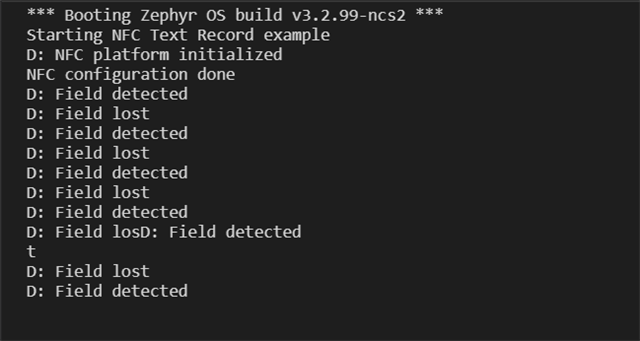

    Also, while trying to debug, I noticed that after tag is read and right before blocking, callback receives "Field detected" event although the polling device (phone) is taken away.

    I have acquired more nRF52 DKs to test, and on new hardware the issue appears much more rare than on initial ones. Also, on new hardware the program started occasionally giving ASSERTION FAIL @ WEST_TOPDIR/zephyr/include/zephyr/spinlock.h:148 when I read the tag.
    So, I guess the problem occurs when spinlock is already locked by one thread and the interrupt tries to lock it again(thus entering deadlock state). But I don't get why one some hardware it invokes Assertion Fail, while on other hardware silently entering deadlock condition.
    After experimenting a little, I found that program consistently enters the same ASSERTION FAIL on unmodified "writable_ndef_msg" sample when reading the tag multiple times. Maybe you could try running it to see if the issue is reproducible there.

    I am sorry, again, for the late reply. Glad to hear that you found a workaround.
    I am not sure exactly what the difference is in the two polling devices, but I guess they are timing related. When I tested with a Samsung and an iPhone, I saw from time to time that the log from the Samsung phone wa cropped (missing linefeeds, and sometimes only half a line before the next one began). This never occured on the iPhone. This suggests that there are timing differences between the polling events in the two devices. I guess these same timing differences are the cause of the issue with the sample as well. The phone is not doing something wrong/illegal, but the nRF's NFC is missing an event (field lost), and then, when it is stuck in this state, it doesn't see any other events. I didn't get to digging into how this is implemented, but I guess you could find something if you check where CONFIG_NFC_ZERO_LATENCY_IRW is being used. Perhaps it disables the button GPIOs IRQ to focus on the NFC being detected, or perhaps the interrupt priority of the NFC event which it doesn't return from is higher than the button interrupts. I guess one of the two.
