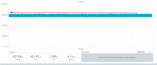

High power usage when access to ADXL345 i2c
Hi, I'm using a Nordic nrf52832 in a custom board. Zephyr is working OK, but i have a strange issue. I have a ADXL345 accelerometer connected with i2c, I can read the sensor OK but has a high power consume, like 600uA when i start reading it and i can't put it to sleep.

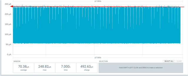

If I never access to the i2c then never get that high power consume, for example if in my device init function i put this:
i2c_dt_spec _accel = {
        .bus = DEVICE_DT_GET(DT_BUS(DT_NODELABEL(accel0))),
        .addr = DT_REG_ADDR(DT_NODELABEL(accel0))
if (!device_is_ready(_accel.bus)) {
        __ASSERT(false, "Accel device is not ready");
Then the power usage of my device maintain a base of ~200-300 uA, but if i only read the ADXL345 ID registry:

Then power usage rise up to ~600uA. I tried to use PM on i2c and not work:
pm_device_action_run(_accel.bus, PM_DEVICE_ACTION_SUSPEND);

Maybe I missing something, but i think that I2C activate on first sensor read and never sleep again, can you help me to find out the problem?
Power Usage of full device without ADXL345 reading:
When use ADXL345 reading:
  • Finnaly found the reason. Is a hardware bug, found on nRF52832 Errata 89. To solve i changed my sleep and wakeup function to this:
