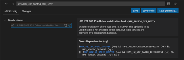

    How do I know what the Kconfig options do (e.g. add files to compilation), preferraby in VS Code to investigate the samples?
    You can use the Kconfig menu to find the different configuration options and information about them. For example:

    Furthermore, VSCode tells me the option CONFIG_NRF_802154_SER_HOST stays n in the build, if i leave it out it still builds and the resulting image seems to be the same. Do I really need that option in the application core? Here are the dependencies from the Kconig menu:
    !NRF_802154_RADIO_DRIVER (=y) && !HAS_HW_NRF_RADIO_IEEE802154 (=y) && HAS_NORDIC_DRIVERS (=y)
    || !NRF_802154_RADIO_DRIVER (=y) && !HAS_HW_NRF_RADIO_IEEE802154 (=y) && HAS_NORDIC_DRIVERS (=y) && 0
    Yes, you need CONFIG_NRF_802154_SER_HOST on the application core if you want to use the nRF 802.15.4 driver. The option is set to n due to missing dependencies. You also need to enable the following:
    CONFIG_IEEE802154_NRF5=y
    CONFIG_NET_L2_IEEE802154=y
    This is needed for the 802154_rpmsg child image:
    CONFIG_PARTITION_MANAGER_ENABLED=y

    after restarting VS Code and doing a prisitne build it did not say anymore CONFIG_NRF_802154_SER_HOST would have missing dependencies. I had the other options set as you suggested and haven't changed anything. So it kinda fixed itself.
