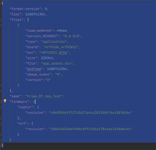

We're using Flutter to build a Bluetooth app for both Android and iOS smartphones.  In order to avoid producing a parsing error, it apparently needs a defined "image_index" and "version" as seen below, which we've manually inserted.  Is there a Kconfig parameter that needs to be set in the nRF connect plug-in for Visual Studio Code to generate these entries?  I've tried Firmware Metadata version number (FW_INFO_FIRMWARE_VERSION) and mcuBOOT Image version (MCUBOOT_IMAGE_VERSION), neither of which produces those fields in the manifest.
