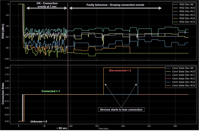

  •  For now we have only touch scanning parameters and first preliminary results seems promising. We've changed scanning parameters from 100ms/100ms (window/interval) to 100ms/1000ms.
    During that test central device was collecting connection state and RSSI values of each individual peripheral device. Measurements were done with old scanning settings (100ms/100ms) and with new (100ms/1000ms) to make back-to-back comparison. We assume that connection event skipping effect can be observable via RSSI sample rate. If RSSI sample rate drops, then we can conclude that connection events are skipping due to scheduling conflict.
    Test results
    Result of scanning parameters of 100ms/100ms. Measurements were done couple of times and repeatablity of tests was high. Connection events start to drop after 80 sec into test and after that device starts to lost connection one at the time. At the end no devices were connected.
    Results of changed scanning parameters to 100ms/1000ms. Connection was stable, there was no sign of connection event skipping. We conclude that scheduling conflict must be reduced a lot or completely solved.
    Measurement conclusion
    Scanning parameter significantly changed multilink BLE connection stability. As it can be seen from test results connection events seems to be more regular and determine. Meaning that scheduling conflict was mitigated or probably complete removed.
