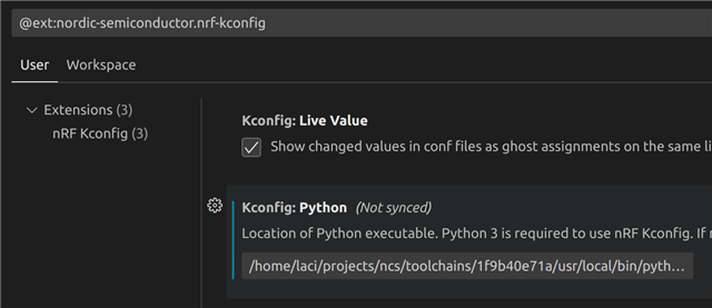

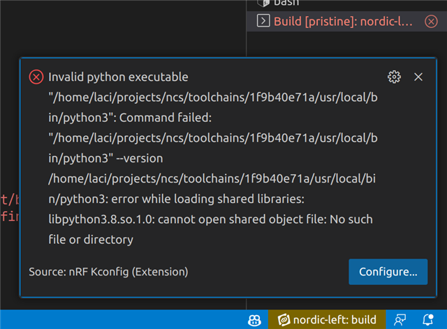

  • When I try the solution contained in the referenced thread, I get the following error:
    The relevant setting that I set:
  • At this point, I think I can not say anything more that:
    Linux Mint is not something we have official support for in the Toolchain Manager, so we can not guarantee that it works.
    I suggest the manual installation as an alternative
