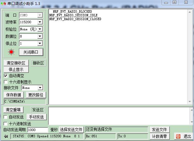

hi,guys For testing the comunication between BLE+timeslot device and radio device, I change the code as below:

BLE+timeslot Device and radio receiver have the same radio config.:

But the radio receiver can not receive data when debugging:

and I'm sure timeslot is working ,cause the uart output just as below:
image description
