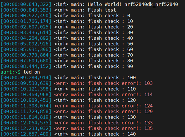

I'm using SPI3 to control an external flash for evaluation.
I implemented a stress test project for read/write functionality on nRF52840DK, but got some errors.
Seems that when system is busy,  spi3 read/write function will work abnormal.
After booting, project will start write data to external flash and read back to verify data.
I use work queue to control led for implement a breath light and turn on/off this function by command.
After I turn on the led function(led on), the reading and writing of the external flash started to have errors.
The test project is attached in the attachment.

    I just wanted to let you know that I have replicated the issue, and it is always reading 256 bytes of 0xFF in the beginning of the rbuf (when expecting a counter value):

    (gdb) print /x rbuf
    $23 = {0xff <repeats 256 times>, 0x0, 0x1, 0x2, 0x3, 0x4, 0x5, 0x6, 0x7, 0x8, 0x9, 0xa, 0xb, 0xc, 0xd, 0xe, 0xf, 0x10, 0x11, 0x12, 0x13, 0x14, 0x15, 0x16, 0x17, 0x18,

    There's two options that I've seen here that helps the scenario.
    1. Change the MAIN_THREAD_PRIORITY to -2 (reduces the chance of the issue occurring)
    2. Update to NCS main - this completely eliminates the issue.
    I haven't found which PR/commit in zephyr that has fixed this issue, but it will be included in the next NCS version.
    Håkon
    Andy Chang said:
    What does "Update to NCS main" mean?
    Run NCS main branch, ie. a place between former tagged version (v2.3.0 at this point) and the upcoming v2.4.0.
    This issue will be fixed in NCS v2.4.0.
