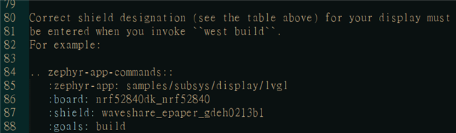

In the file index.rst (Found in zephyr/boards/shields/waveshare_epaper/doc) the above segment is found.
That seems like it would be the answer to my question, but I have not yet seen a file where these "zephyr-app-commands" are used. Where might they be added?

    This can be achieved when creating a build configuration (or editing an existing one). There is a field for "Extra CMake arguments" where you can add the -DSHIELD option you need. I know that this might not be obvious, since you usually only create a build config once and then forget about that screen.
    Note that you have to press the "OK" button for the argument to be saved!
