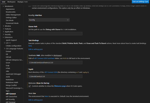

  • I have tried lots of variants in the settings
    In the settings on my other laptop which works without issues settings are set to ${nrf-connect.toolchain:2.3.0} and ${nrf-connect.sdk:2.3.0} respectively.
    I have been tried copying the settings.json from the working laptop
  • The settings file says that you have modified the toolchain path in the current workspace, can you share the *.code-workspace file and it's path?
  • I have modified it after it failed in trying to get it working by typing in the toolchain and SDK paths manually but with no luck.
    Are you talking about the following ones?
    	"folders": [
    			"path": "C:/Nordic/MyApps"
    	"settings": {
    		"nrf-connect.toolchain.path": "c:\\NordicSemi\\toolchains\\v2.3.0"
    Path for the workspace Settings:
    C:\Users\Jev\AppData\Roaming\Code\Workspaces\1683734868683
        "nrf-connect.welcome.showOnStartup": true,
        "nrf-connect.enableTelemetry": true,
        "nrf-connect.toolchain.path": "C:\\NordicSemi\\toolchains\\v2.3.0",
        "nrf-connect.topdir": "C:\\NordicSemi\\v2.3.0"
    Path for the User Settings:
    C:\Users\Jev\AppData\Roaming\Code\User
  • Hmm. I don't see anything obviously wrong.
    Try copying this workspace file into "C:\\NordicSemi\\v2.3.0", then in VS Code you go to 'File' -> 'Open Workspace from File" and choose "C:\\NordicSemi\\v2.3.0\\v2.3.0.code-workspace". After that you can try to verify the toolchain via the nRF plugin's welcome page.
