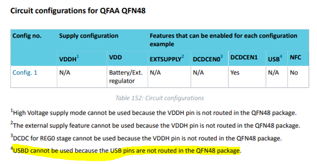

I cannot find any pin assignment for D-, D+ and Vbus for the QFN48 package of nRF52811. Is USB-funtionality not implemented in this package, or is the information missing in the product specification?

Sorry, i meant the nRF52840
The QFN48 package type is limited due to the less number of pins available and hence does not have USB support.
