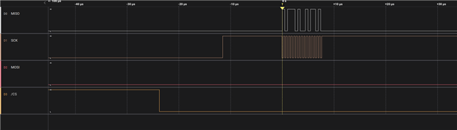

I have encountered an issue with the configuration of the Pixart PMW3360 device when using SDK versions higher than NRF-Connect SDK 2.0.2. After researching the development progress on GitHub, I noticed significant changes to the SPI handling mechanism, which seems to be causing the problem.
When attempting to configure the PMW3360 device using SDK versions above NRF-Connect SDK 2.0.2, the configuration process fails to complete successfully. The device does not respond as expected when uploading firmware to the device, leading to the device not being initialized. This issue arises specifically with SDK versions beyond 2.0.2.

While exploring the development changes on GitHub, I noticed modifications related to the handling of SPI. These changes seem to have an impact on the NRF PMW3360 device's configuration process. It appears that the alteration to the SPI handling mechanism in SDK versions after 2.0.2 is causing compatibility issues.
Hopefully, this issue can be resolved,
