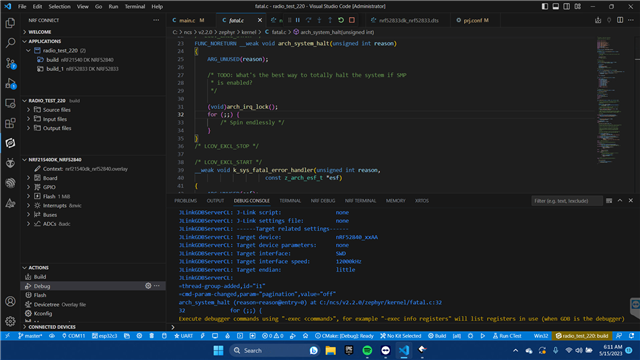

  • Hi Sigurd!
    Thank you so much for the response!
    Debug log

    arch_system_halt (reason=reason@entry=0) at C:/ncs/v2.2.0/zephyr/kernel/fatal.c:32
    32		for (;;) {
    Execute debugger commands using "-exec <command>", for example "-exec info registers" will list registers in use (when GDB is the debugger)

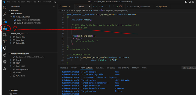

    By looking at the call stack, we might be able to see why it ended up in the error_handler. Open the debugger tab to have a look at the call stack.
