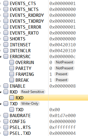

APP_UART_COMMUNICATION_ERROR in uart_event_handler after calling function APP_UART_INIT(&comm_params, uart_event_handle, APP_IRQ_PRIORITY_LOWEST, err_code);
    Im working on n2f52805 where i need to include uart in my application.But when i call APP_UART_INIT function it is giving an event in uart_event_handle and giving the error APP_UART_COMMUNICATION_ERROR .In this project custom ble is working.I don't want to use uart fifo so i removed app_uart_fifo.c and added app_uart.c .

  • Hi there,
    Can you read out the ERRORSRC register when you get this error?
    regards
    Jared
  • Yes the rx pin state is low . Also im using p0.5 as rx,and p0.4 as tx.
    Could you tell me how to use this function NRF_GPIO->PIN_CNF[RX_PIN_NUMBER] to pull up.In my project i dont have libraries for gpio peripheral.
  • I use this function  nrf_gpio_cfg_input(RX_PIN_NUMBER, NRF_GPIO_PIN_PULLUP); before uart_init(); .Now the rx pin is set but after this function nrf_drv_uart_init(&app_uart_inst, &config, uart_event_handler); the rx pin state becomes low and giving the same error
  • What if you move it to after nrf_drv_uart_init()?
    regards
    Jared
  • I added external pull up for both rx and tx pins . Now the tx and rx started working but in uart handle im not able to send a complete string . When i try to send it on the uart handle then it is only send the first byte.I'm able the send strings in while loop.Rx data reception is working perferctly.
