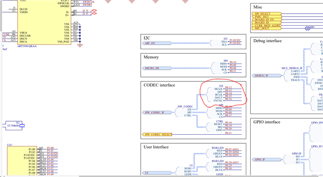

I'm trying to find the I2S pins on the nRF5340 DK board, in order to connect an external hardware codec.
I've read nRF5340 product brief, and it specifies I2S compatible, however I don't find any reference of I2S in nRF5340 DK Hardware user guide. I know I can find nRK5340 Audio DK, but it is unavailable and I'd like to use nRF5340 DK.
Can you help me find the right pins in nRF5340 DK?
    Are you using a specific example? The I2S peripheral doesn't have dedicated pins, it can use any available GPIO pin.

  • I'm trying to use the nRF5340 Audio example in the nRF5340 DK board. I'm trying to find where are the I2S pins are so I can connect an external codec.
    By looking at the nrf5340 audio example, I can't find where the I2S or GPIO pins are defined.
    After reading nRF5340 Product Specification p.253, I was trying to find similarities with nrf5340 audio example to find where are the i2S pin configuration is located, but couldn't find anything similar (e.g. NRF_I2S structure, PSEL.LRCK, PSEL.SCK... none of these keywords returned anything).

  • I'm building the example with the nRF5340 DK board. I don't have connected the hardware codec, I'm trying to identify what are the pins I need to connect the codec to (which is my main question). It is not the same codec as in the nRF5340 Audio DK board.

  • any available GPIO pin can be used for the I2S peripheral. If you're using the audio application then it will use specific pins set by the application, if you share your build folder then I can check which pins that are assigned for the I2S peripheral and answer your main question or you can go into the build folder and check Zephyr.dts and see which pins are assigned to the I2S peripheral.
    If it's not the same codec then you probably need to either create a new driver or check and see if that codec already has a driver in zephyr. It wont be as easy as just building the application and connect the codec.
