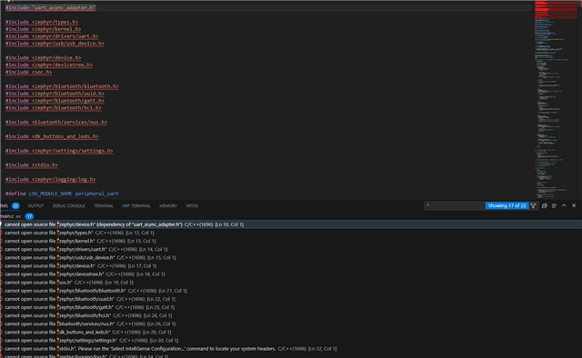

we are using a laird bl651 with the nordic nrf52810 chip. I am followed your instructions on how to getting started installing all the necessary things and configuring. In the past I have used your IDE and after some troubles I was able to somehow compile and flash the firmware, now it should be working but it is not. I am trying with the "peripheral_uart" example for a custom board I created using the nrf52810.  As I open the program I get a lot of errors from inclusion of libraries, but I do not know why that would happen, I have roughly followed your guide. I will attach a screenshot here:

    The errors in your screenshot are not directly related to the Nordic SDK or your program, it's just the VS Code IDE trying to locate the header files, which it sometimes has problems with because of how the SDK is structured.
    Have you tried building your project with the nRF Connect extension anyway?
    If it doesn't build, could you share the build log?
