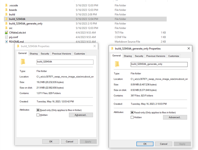

    I use the VS Code Extension in my work, and what I observe is that there are two options to reduce the size of the build folder.
    1. The first one is recreating it, and stop at the generating step, not build.
    2. The second is to run west build -t clean.
    I have seen that the recreating is significantly smaller with significantly fewer file. So, I often try to go with this.
