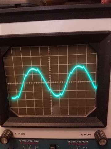

  • For the buzzing, I set the sin wave frequency to 400Hz to get exactly 100 PWM cycles per sin wave cycle and I set the buffer to 25 duties to get exactly 4 buffer refreshes per sine wave cycle.  The result is what is in the attached image, you can very clearly see a voltage jump every time the PWM loop restarts.
    (edit: I also was only using sequence 1 and not sequence 0 in this test)
    Oscilloscope picture showing a voltage jump every buffer refresh
  • it seems my code can't swap the buffer fast enough and the last two values of the previous frame get reused before the buffer is swapped.  Unfortunately I can't seem to get PWM interrupts to work in order to swap the buffer fast enough.
