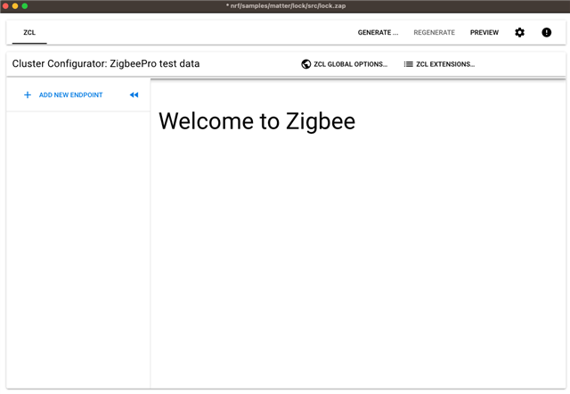

  • Hi Dan,
    I've exactly the same problem. The same procedure, the same result. Also tried to download release from chip github, but I don't see matter products when adding endpoint 0.
  • I had another private ticket related to the same issue, and I discovered that I had to extract the zip manually instead of using the Python script for some reason:
    "I was finally able to reproduce the same error here, and it appears to be related to how the zip file is being extracted by the Python script.
    Please change the directory to /opt/nordic/ncs/v2.3.0/modules/lib/matter/location_path in the terminal and delete the existing files and folders before running this command.
    "wget github.com/.../zap-mac.zip && unzip -d zap-mac zap-mac.zip && ../../../../nrf/samples/matter/sensor/src/template."
    After the zip is downloaded and extracted, make sure that both /opt/nordic/ncs/v2.3.0/modules/lib/matter/location_path/zap-mac/zap.app/Contents/MacOS/ and /opt/nordic/ncs/v2.3.0/modules/lib/matter/location_path/zap-mac/ are added to PATH.
    I have reported this as a bug internally. It seems like only macOS is affected by this.
  • Hi Vidar,
    thanks for your answer. I followed your instructions and it looks zap tool works!
    Unfortunately when opening zap tool with
    zap src/template.zap
    in my project folder I cannot add any matter endpoint. Is there any extension which I should add to see Matter clusters?
