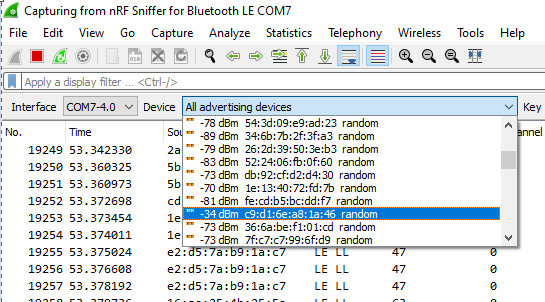

Do you have BLE timeout error on the Ubuntu's side ( I assume it's the central ? ) or on the nRF52840 ?
Do you have any log on the nRF52840 ?
Which sample you are running on the nRF52840 ? On the Ubuntu I assume you are running the chip-tool application ?
I would suggest to capture a sniffer trace to see what happens over the air.

Hi Gautam,
I'm sorry for the late response. It's holiday in Norway last week.
Your new trace still doesn't capture the communication between the two devices.
My suggestion is to follow our course on capturing sniffer trace here: https://academy.nordicsemi.com/lessons/lesson-6-bluetooth-le-sniffer/
What you need to look for when capturing the trace is to see the connection established and the communication before it's terminated.

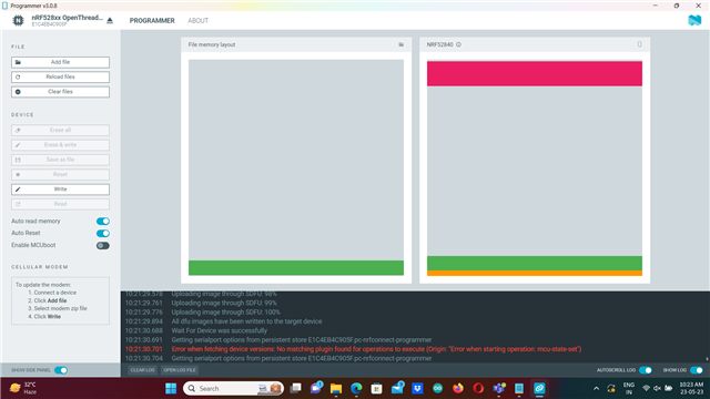

actually we have switch to BLE-thread so we are not longer work on BLE-wifi,in BLE-thread i got an error when make OTBR.
this error i got when i try to upload hex code in nrf52840 dongle and i am using 3.0.8 version and i have akso try this on latest version.
Hi Gautam,
Could you tell me which exact firmware you are flashing ot the nRF52840 dongle ?
As far as I know it's normal that after DFU update the programmer can not communicate with the dongle (until you put the dongle into DFU mode again).
actually i am flashing this code which give me an error.
this file i generate from this link https://openthread.io/codelabs/openthread-hardware#3
Hi Gautam,
I'm not so sure the firmware is made for the dongle. It's the nRF52840 Dev Kit you should flash it on , not the dongle.
On the dongle there is a bootloader and that require the application location to be adjusted. (Unless you have soldered the SWD port to erase the bootloader and flash directly)
Could you please try testing on a Dev Kit instead ?

Hi Gautam,
Could you please try follow the sniffer course and try capture the sniffer trace ? We need to see how the disconnect happen. To see if it's a BLE issue or it's related to Matter.
