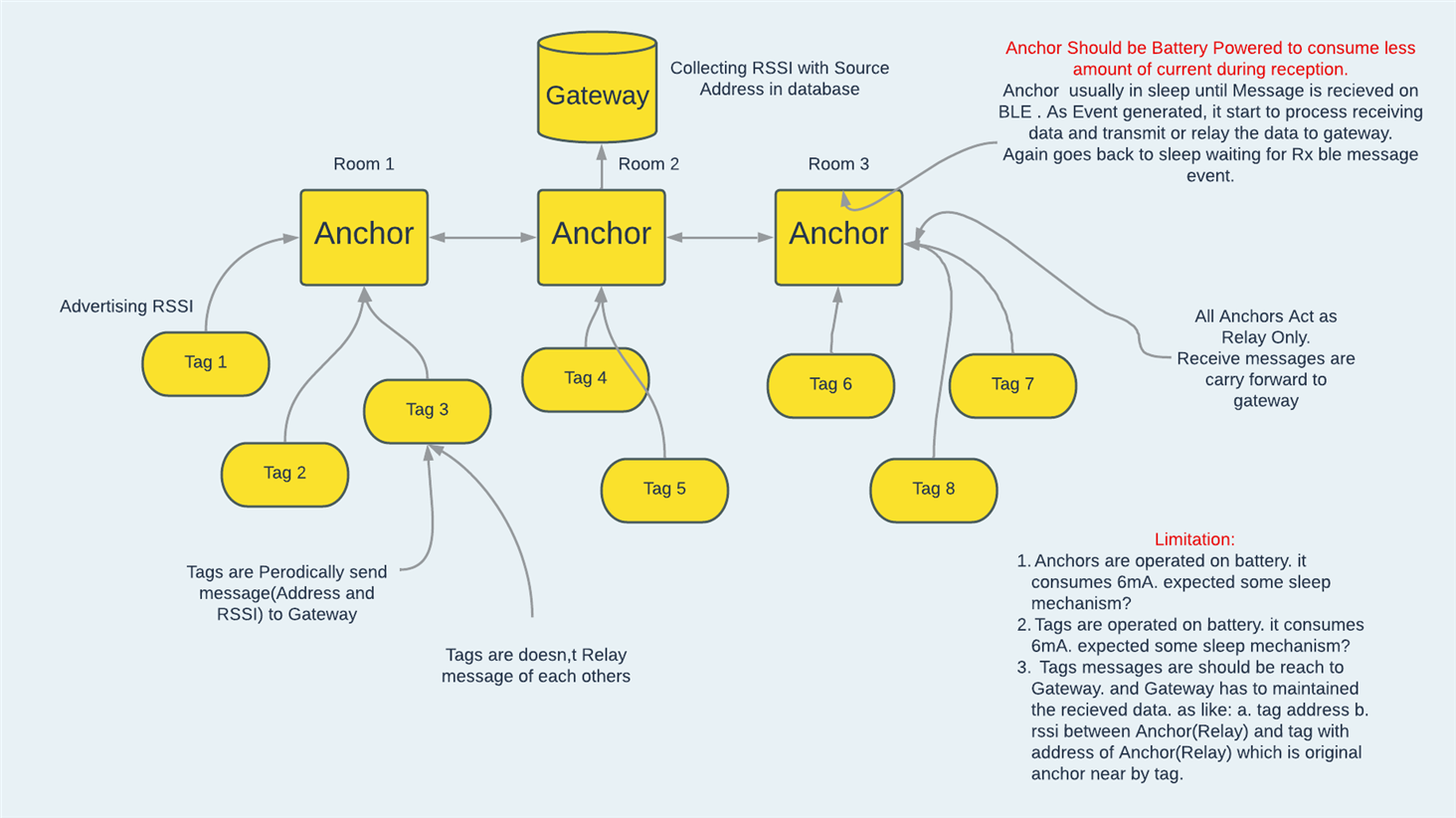

i am using nrf connect extension in vs code with Zephyr OS build v3.2.99-ncs2 and Nrf connect SDK 2.3.0. Our Application requirement as Shown in below Image.
Anchor:   Sleep -> Wakeup on BLE event -> Receive message and Process data -> Message Carry forward to Gateway-> Goes back to sleep. Anchors are Battery Powered. how can i achieve sleep mechanism with nrf52832 soc?  because continuous reception leads to more power consumption. it drained out battery very quickly. are there any available example on sleep in reception of BLE Mesh?

    If the data must be relayed from anchor to anchor before reaching the gateway, then the anchors must be Bluetooth mesh relay nodes, which means they must be constantly in RX. This is by specification, and this is how the relay nodes are able to reliably relay messages over the network. There really isn't any way to change that behavior. Relay nodes will constantly consume around 6 mA.
    Bluetooth mesh relies on having a backbone of relay nodes that are always on, for transferring messages over the network. Low power nodes (LPN) can save power and only turn on the radio when they need to send something or check for incoming messages. Relay nodes, on the other hand, must be always on.
    One pattern, is if you have relay nodes (always on) listening for advertisements from beacons. Then the beacons can have even lower power than LPN, but they cannot receive any information from the mesh network itself. This is what we do for the Bluetooth: Mesh Silvair EnOcean example, which listens for advertisements from a specific switch which is powered solely by the button presses. Please note that the listener is a normal mesh node, always in RX, just as relay nodes. It is not an LPN.

     All Tags are sending message to gateway though Anchor.  Anchor act as Relay. All each Anchor want to transmit their message to Gateway. One tag range in Between multiple Anchors. it become cluster of messages. does this lead to flooding of messages on Anchor side? are their any repeat of messages protection in Mesh?

    Bluetooth mesh uses managed flooding. This means there are mechanisms in place for controlling the rate of the flood, to prevent congestion and overload of single nodes. You will still see some limits for throughput. How many sensor do you have, and what throughput do you expect from each sensor?

    Tags: 3000 units
    Anchors: 150 - 200 units

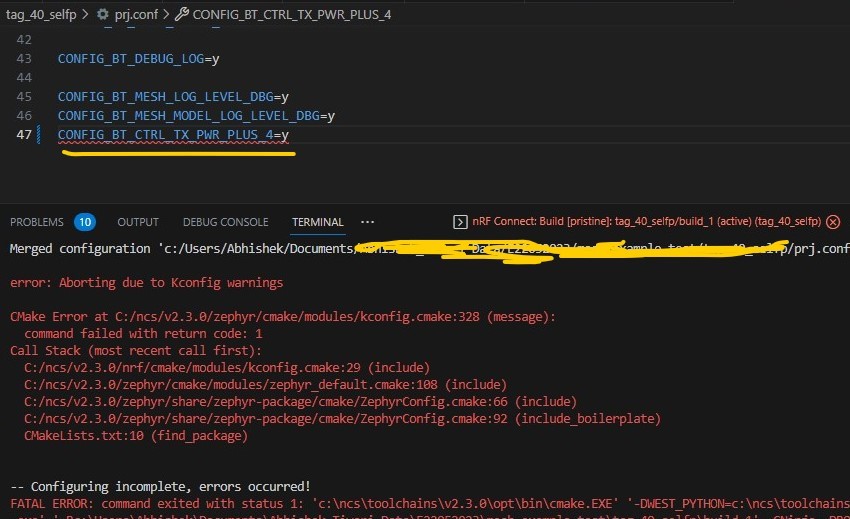

    Are there any way to set or change  Tx power between 0 to 4dbm of BLE in SDK ? API or Function to call in Zephyr /Nrf connect SDK?
    We want to configure TX power of BLE antenna according to Requirement of Application,  Mesh Example: https://developer.nordicsemi.com/nRF_Connect_SDK/doc/2.3.0/zephyr/samples/bluetooth/mesh/README.html

    With three thousand tags, there is not much bandwidth in a Bluetooth mesh network for relaying all of that to a gateway. What throughput do you expect from each tag? That is - how often and how much data is the tag producing?
    You can add one of the CONFIG_BT_CTRL_TX_PWR_ kconfigs to your project configuration file (prj.conf), for instance:
    CONFIG_BT_CTRL_TX_PWR_PLUS_4=y

    Tags: Sleep(2,2uA) -> Wakeup-> Transmit Message(1 byte)-> Sleep periodically in interval of 5 min. Tags are Battery Powered. how set high data rate so that data in air is minimum?
    Error:
