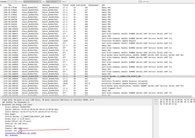

How long does it take for the new negotiated connection interval to get applied?
I am using nrf52832 as a peripheral and running SD S112, nordic UART Profile and SDK 17.1.0 on it.
I am requesting the update connection parameter between  60ms to 105ms. I  see that the central has accepted the request and has also sent the LLCP connection update Indication.
However I see that for about 8-9 secs the peripheral is still using the old connection interval. ( my old connection interval is 1005ms)
What could be the reason for new connection interval not getting set immediately ?
In the attached sniffer log please refer to line 1272.
Thank you. sniffer_log.pcapng
