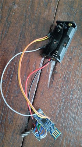

I successfully installed a SX1276 with a nRF5340 and transmitted some lorawan packets to Helium Network.

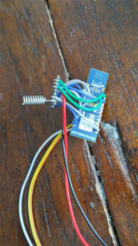

After I concluded I could do the same using the nRF52840. So I installed another one module solded on dongle's pin.
In order to start this project I created the blink to know if the things were working. The led1 blinked.
After I just adjusted the .overlay and organized the pins, at same way I done using the other project.
And I put some lorawan configs on .prj.
For my surprise, the led didn't blink.
In order to test, doesn't need connect anything because the problem is only the configs.
