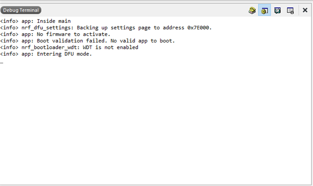

Bootloader is not discoverable
I am trying to integrate bootloader to my firmware, But after integrating bootloader to my firmware it's not discoverable.
This is the debug terminal result when I try to debug but I can't see any device showing on nrf Connect app
Using nrf52832, SDK 16.00
Furthermore,
1)   Led 2 is blinking

2).. When I comment out the bootloader code but add its files to my firmware an error occurs as
app: ERROR 1 [NRF_ERROR_SVC_HANDLER_MISSING] PC at: 0x0002FF01
The error is being shown in ble_stack_init, but this function looks fine

  • After conducting research, I discovered that it is not necessary to integrate the secure bootloader code into our firmware. Instead, we can only utilize code for Device Firmware Update (DFU). I have implemented this approach and made the device discoverable and capable of firmware updates.
    However, I am currently facing an issue where, after programming the device with a secure bootloader example and subsequently updating the firmware, problems arise, such as the failure to notify sensor values
    And when I program the device with simply my firmware, it perfectly notifies sensor values.
    How can solve this issue?
    Can you elaborate on what you mean when you say "failure to notify sensor values"? Is this a problem with sending notifications over BLE, or receiving values from a sensor?
    Jørgen
  • Yes, There is an issue in receiving  values from a sensor,
    I am getting every value perfectly fine when I run the firmware directly but when I update the same firmware from another firmware I  don't receive sensor values in NUS service
  • Is the device working as expected apart from sending the sensor data over NUS? Do you see any issues on the log from the device? Have you tried debugging the firmware after it has been updated over DFU?
  • yes device is working fine apart from not sending the sensor data in ,
    Sometimes when I upload the firmware directly, I can't update any firmware zip file on it
    However, I tested the same zip file by updating it on another firmware, There is no problem in zip file but there is problem in my firmware but I don't know where it is as everything seems pretty normal
    This is the code,

                ble_adv_modes_config_t config;
                advertising_config_get(&config);
                config.ble_adv_on_disconnect_disabled = true;
                ble_advertising_modes_config_set(&m_advertising, &config);
                // Disconnect all other bonded devices that currently are connected.
                // This is required to receive a service changed indication
                // on bootup after a successful (or aborted) Device Firmware Update.
                uint32_t conn_count = ble_conn_state_for_each_connected(disconnect, NULL);
                NRF_LOG_INFO("Disconnected %d links.", conn_count);
            case BLE_DFU_EVT_BOOTLOADER_ENTER:
                // YOUR_JOB: Write app-specific unwritten data to FLASH, control finalization of this
                //           by delaying reset by reporting false in app_shutdown_handler
                NRF_LOG_INFO("Device will enter bootloader mode.");
            case BLE_DFU_EVT_BOOTLOADER_ENTER_FAILED:
                NRF_LOG_ERROR("Request to enter bootloader mode failed asynchroneously.");
                // YOUR_JOB: Take corrective measures to resolve the issue
                //           like calling APP_ERROR_CHECK to reset the device.
            case BLE_DFU_EVT_RESPONSE_SEND_ERROR:
                NRF_LOG_ERROR("Request to send a response to client failed.");
                APP_ERROR_CHECK(false);
            default:
                NRF_LOG_ERROR("Unknown event from ble_dfu_buttonless.");
     * @warning This handler is an example only and does not fit a final product. You need to analyse
    ///**@brief Function for initializing the timer module.
    //static void timers_init(void)
    //    ret_code_t err_code = app_timer_init();
    //    APP_ERROR_CHECK(err_code);
                                              strlen(DEVICE_NAME));
        APP_ERROR_HANDLER(nrf_error);
     * @param[in] p_evt       Nordic UART Service event.
            uint32_t err_code;
               //memcpy(data, p_evt->params.rx_data.p_data, p_evt->params.rx_data.length);
                do
                    if ((err_code != NRF_SUCCESS) && (err_code != NRF_ERROR_BUSY))
                        NRF_LOG_ERROR("Failed receiving NUS message. Error 0x%x. ", err_code);
            if (p_evt->params.rx_data.p_data[p_evt->params.rx_data.length - 1] == '\r')
        uint32_t           err_code;
        ble_nus_init_t     nus_init;
        ble_bas_init_t     bas_init;
        //ble_dfu_init_t   dfus_init;
        ble_dfu_buttonless_init_t dfus_init = {0};
        // Initialize DFU buttonless.
        dfus_init.evt_handler = ble_dfu_evt_handler;
        err_code =  ble_dfu_buttonless_init(&dfus_init);
        // Initialize NUS.
      // Initialize Battery Service.
          memset(&bas_init, 0, sizeof(bas_init));
        bas_init.evt_handler          = NULL;
        bas_init.support_notification = true;
        bas_init.p_report_ref         = NULL;
        bas_init.initial_batt_level   = 100;
         // Here the sec level for the Battery Service can be changed/increased.
        bas_init.bl_rd_sec        = SEC_OPEN;
        bas_init.bl_cccd_wr_sec   = SEC_OPEN;
        bas_init.bl_report_rd_sec = SEC_OPEN;
        err_code = ble_bas_init(&m_bas, &bas_init);
    /**@brief Function for initializing the sensor simulators.
    //static void sensor_simulator_init(void)
    //    m_battery_sim_cfg.min          = MIN_BATTERY_LEVEL;
    //    m_battery_sim_cfg.max          = MAX_BATTERY_LEVEL;
    //    m_battery_sim_cfg.incr         = BATTERY_LEVEL_INCREMENT;
    //    m_battery_sim_cfg.start_at_max = true;
    /**@brief Function for starting application timers.
    static void application_timers_start(void)
        ret_code_t err_code;
        // Start application timers.
        err_code = app_timer_start(m_battery_timer_id, BATTERY_LEVEL_MEAS_INTERVAL, NULL);
        uint32_t err_code;
        // Prepare wakeup buttons.
        uint32_t err_code;
        switch (ble_adv_evt)
            case BLE_ADV_EVT_FAST:
              case BLE_ADV_EVT_IDLE:
                sleep_mode_enter();
            default:
        uint32_t err_code;
            case BLE_GAP_EVT_CONNECTED:
                NRF_LOG_INFO("Connected");
                NRF_LOG_INFO("Disconnected");
                ble_gap_phys_t const phys =
                    .rx_phys = BLE_GAP_PHY_AUTO,
                    .tx_phys = BLE_GAP_PHY_AUTO,
            } break;
                // Pairing not supported
            case BLE_GATTC_EVT_TIMEOUT:
            case BLE_GATTS_EVT_TIMEOUT:
            default:
                // No implementation needed.
        uint32_t ram_start = 0;
        // Enable BLE stack.
    void gatt_init(void)
        uint32_t err_code;
        switch (event)
         case BSP_EVENT_SLEEP:
                sleep_mode_enter();
            case BSP_EVENT_DISCONNECT:
            case BSP_EVENT_WHITELIST_OFF:
            default:
     *          'new line' '\n' (hex 0x0A) or if the string has reached the maximum data length.
        static uint8_t index = 0;
        uint32_t       err_code;
        switch (p_event->evt_type)
            case APP_UART_DATA_READY:
                index++;
                     (index >= m_ble_nus_max_data_len))
                    if (index > 1)
                        do
                            err_code = ble_nus_data_send(&m_nus,data_array, &length, m_conn_handle);
                    index = 0;
            case APP_UART_FIFO_ERROR:
            default:
    static void uart_init(void)
            .rx_pin_no    = RX_PIN_NUMBER,
            .tx_pin_no    = TX_PIN_NUMBER,
            .use_parity   = false,
    #if defined (UART_PRESENT)
            .baud_rate    = NRF_UART_BAUDRATE_115200
    #else
            .baud_rate    = NRF_UARTE_BAUDRATE_115200
                           UART_RX_BUF_SIZE,
                           UART_TX_BUF_SIZE,
                           uart_event_handle,
                           APP_IRQ_PRIORITY_LOWEST,
                           err_code);
        ble_advertising_init_t init;
        init.advdata.flags              = BLE_GAP_ADV_FLAGS_LE_ONLY_GENERAL_DISC_MODE;
        bsp_event_t startup_event;
        uint32_t err_code = bsp_init(BSP_INIT_LEDS | BSP_INIT_BUTTONS, bsp_event_handler);
    static void log_init(void)
        UNUSED_RETURN_VALUE(NRF_LOG_PROCESS());
        nrf_pwr_mgmt_run();
        uint32_t err_code = ble_advertising_start(&m_advertising, BLE_ADV_MODE_FAST);
    void timer_handler(nrf_timer_event_t event_type, void* p_context)
    void saadc_sampling_event_init(void)
        err_code = nrf_drv_ppi_init();
        timer_cfg.bit_width = NRF_TIMER_BIT_WIDTH_32;
        err_code = nrf_drv_timer_init(&m_timer, &timer_cfg, timer_handler);
        /* setup m_timer for compare event every _____ms */
        uint32_t ticks = nrf_drv_timer_ms_to_ticks(&m_timer, 5000);
        nrf_drv_timer_extended_compare(&m_timer, NRF_TIMER_CC_CHANNEL0, ticks, NRF_TIMER_SHORT_COMPARE0_CLEAR_MASK, false);
        nrf_drv_timer_enable(&m_timer);
        uint32_t timer_compare_event_addr = nrf_drv_timer_compare_event_address_get(&m_timer, NRF_TIMER_CC_CHANNEL0);
        uint32_t saadc_sample_task_addr   = nrf_drv_saadc_sample_task_get();
        /* setup ppi channel so that timer compare event is triggering sample task in SAADC */
        err_code = nrf_drv_ppi_channel_alloc(&m_ppi_channel);
        err_code = nrf_drv_ppi_channel_assign(m_ppi_channel,
                                              timer_compare_event_addr,
                                              saadc_sample_task_addr);
    void saadc_sampling_event_enable(void)
        ret_code_t err_code = nrf_drv_ppi_channel_enable(m_ppi_channel);
    float f1;
    float f2;
    float f3;
    float f4;
    float X;
    float Y;
    int samples=15;
    // check if the sampling is done and we are ready to take these samples for processing
        if(p_event -> type == NRFX_SAADC_EVT_DONE)
          ret_code_t err_code; //store errors code
          nrf_saadc_value_t adc_result; uint16_t batt_lvl_in_milli_volts; uint8_t percentage_batt_lvl;
    adc_result = p_event->data.done.p_buffer[4];
    // A function to take the samples (which are in the buffer in the form of 2's complement), and convert them to 16-bit interger values
          err_code = nrfx_saadc_buffer_convert(p_event->data.done.p_buffer, SAMPLES_IN_BUFFER);
          int i;
          printf("ADC Event Occurred!!\r\n");
    batt_lvl_in_milli_volts = ADC_RESULT_IN_MILLI_VOLTS (adc_result) + DIODE_FWD_VOLT_DROP_MILLIVOLTS;
    percentage_batt_lvl = battery_level_in_percent (batt_lvl_in_milli_volts);
    NRF_LOG_INFO("Battery in %03d%%", percentage_batt_lvl);
        err_code = ble_bas_battery_level_update(&m_bas, battery_level, BLE_CONN_HANDLE_ALL);
            (err_code != NRF_ERROR_INVALID_STATE) &&
            (err_code != NRF_ERROR_BUSY) &&
            (err_code != BLE_ERROR_GATTS_SYS_ATTR_MISSING)
            APP_ERROR_HANDLER(err_code);
          for(i = 0; i<SAMPLES_IN_BUFFER; i++)
           if(i==0){
          // read the variable and print it
            f1 = p_event->data.done.p_buffer[i];
            if (i==1){
            f2 = p_event->data.done.p_buffer[i];
            if (i==2){
            f3 = p_event->data.done.p_buffer[i];
            if(i==3){
            f4 = p_event->data.done.p_buffer[i];
        Xc=f1+f2;
       printf("Xc: " NRF_LOG_FLOAT_MARKER "\r\n", NRF_LOG_FLOAT(Xc));
        Yc=y_f3+f4;
       printf("Yc: " NRF_LOG_FLOAT_MARKER "\r\n", NRF_LOG_FLOAT(Yc));
      float sum=0.0;
    float sum1=0.0;
    for(int a=0; a<=samples; a++){
    sum= sum+Xc;
    sum1= sum1+Yc;
    Xcop=sum/samples;
       printf("Xc average: " NRF_LOG_FLOAT_MARKER "\r\n", NRF_LOG_FLOAT(X));
    Ycop=sum1/samples;
      printf("Yc average: " NRF_LOG_FLOAT_MARKER "\r\n", NRF_LOG_FLOAT(Y));
    uint32_t err_code;
    uint16_t length ;
    uint8_t data[50];
    length = sprintf(data, "X = %f, Y = %f\r\n", X,Y);
    err_code = ble_nus_data_send(&m_nus, data, &length, m_conn_handle);
    if ((err_code != NRF_ERROR_INVALID_STATE) && (err_code != NRF_ERROR_NOT_FOUND))
    else
    return;
    void saadc_init(void)
    // Create structs to hold the default configurations which will be used to initialize the adc module.
      nrf_saadc_channel_config_t channel1_config = NRFX_SAADC_DEFAULT_CHANNEL_CONFIG_SE(NRF_SAADC_INPUT_AIN1);
      nrf_saadc_channel_config_t channel2_config = NRFX_SAADC_DEFAULT_CHANNEL_CONFIG_SE(NRF_SAADC_INPUT_AIN2);
      nrf_saadc_channel_config_t channel3_config = NRFX_SAADC_DEFAULT_CHANNEL_CONFIG_SE(NRF_SAADC_INPUT_AIN4);
      nrf_saadc_channel_config_t channel4_config = NRFX_SAADC_DEFAULT_CHANNEL_CONFIG_SE(NRF_SAADC_INPUT_AIN5);
      nrf_saadc_channel_config_t channel5_config = NRFX_SAADC_DEFAULT_CHANNEL_CONFIG_SE(NRF_SAADC_INPUT_VDD);
      err_code = nrf_drv_saadc_init(NULL, saadc_callback);
    // allocate the channel along with the configurations
      err_code = nrfx_saadc_channel_init(0, &channel1_config);
      err_code = nrfx_saadc_channel_init(1, &channel2_config);
      err_code = nrfx_saadc_channel_init(2, &channel3_config);
      err_code = nrfx_saadc_channel_init(3, &channel4_config);
     err_code = nrfx_saadc_channel_init(4, &channel5_config);
    // allocate first buffer(array) where the values will be stored once sampled
      err_code = nrfx_saadc_buffer_convert(m_buffer_pool[0], SAMPLES_IN_BUFFER);
    // allocate second buffer where the values will be stored if overwritten on first before reading
      err_code = nrfx_saadc_buffer_convert(m_buffer_pool[1], SAMPLES_IN_BUFFER);
    /**@brief Function for performing battery measurement and updating the Battery Level characteristic
     *        in Battery Service.
    /**@brief Function for handling the Battery measurement timer timeout.
     * @details This function will be called each time the battery level measurement timer expires.
     * @param[in] p_context  Pointer used for passing some arbitrary information (context) from the
     *                       app_start_timer() call to the timeout handler.
    static void battery_level_meas_timeout_handler(void * p_context)
        UNUSED_PARAMETER(p_context);
        saadc_init();
         err_code = nrf_drv_saadc_sample();
      printf("%s", __func__);
            // Create timers.
        err_code = app_timer_create(&m_battery_timer_id,
                                    APP_TIMER_MODE_REPEATED,
                                    battery_level_meas_timeout_handler);
    {   ret_code_t err_code;
        bool erase_bonds;
     //// Initialize the async SVCI interface to bootloader before any interrupts are enabled.
     //   err_code = ble_dfu_buttonless_async_svci_init();
      //timers_init();
        // Initialize.
        uart_init();
        log_init();
        timers_init();
        power_management_init();
        ble_stack_init();
        gap_params_init();
        gatt_init();
        services_init();
        advertising_init();
        conn_params_init();
        saadc_sampling_event_init();
        saadc_init();
        saadc_sampling_event_enable();
        // Start execution.
        printf("\r\nUART started.\r\n");
        advertising_start();
        // Enter main loop.
        for (;;)
            idle_state_handle();
  • You should connect a debugger to see if there is any errors in your application, and read out the log from the device. It is very hard to give any suggestions on what is failing from your current description of the problem.
