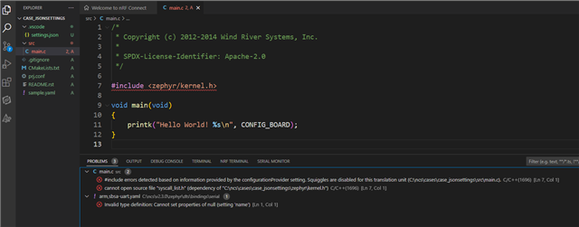

Hi, when I create a project using vscode nrf-connect, I can't load inclusions as shown below.
I added the c_cpp_properties.json -> includePath path as shown below, but I still can't find the file.

I'm sorry. I'm using a translator, but I attached a language other than English.
I followed the setup and installation process video on YouTube.
And when I create a new project, I can't load the header file like the attached picture in the text.

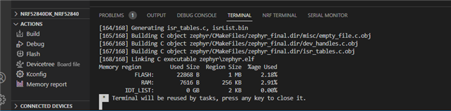

Did you try building the project?
When I create hello world project in NCS 2.3.0, I see following error in the "problems" window
which is exactly similar to what you have shown.
However, when I build the project for DK, it is successfully built.
