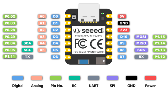

  • I'm using openthread to receive UDP packets on the Xiao and want to pass the received message to the host MCU through UART. Similarly, I want to receive UART messages from the host MCU and send them via UDP.
    I have tried simply sending a hello world message to the host MCU but the message is not received. The tx and rx pins are indeed mapped out on the physical board as shown below.
    Could the issue be because I'm using openthread? Can I map the tx pin to some other pin using the zephyr device tree or proj.conf file?
    This should be simple, but doesn't seem to work.
    I think it would be much easier to debug this if you started with a simpler application. Can you for instance run the Zephyr UART driver sample successfully on your board?
