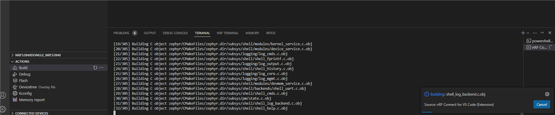

  • Hi JM,
    Could you please try to test with the examples we have in the SDK, not the fundamental BLE course ? For example peripheral_uart and peripheral_lbs located in \nrf\samples\bluetooth
    In your screenshot it's not the build log, have you tried to build ?
    It should look like this:
    You may want to try re-install Visual Studio Code and the nRF Connect extension.

    Please show us the issue when you build the project, not when you just open the project. As I showed you in the last reply.
