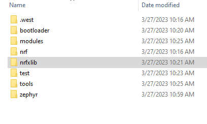

While investigating why there was a problem with accessing #include files, I found that the subdirectory \v2.2.0\zephyr\include had disappeared from the \v2.2.0\zephyr directory on my PC !!
So I decided to install the latest version of nRF Connect  SDK v2.3.0 in the new directory: c:\Nordic-230 , to replace my existing version of the nRF Connect SDK v2.2.0.
After I installed the latest version of nRF Connect SDK v2.3.0 , I verified that the #include files were present in the c:\Nordic-230\v2.3.0\zephyr\include directory.
I then tried to make another version of the build of the sample: lesson6/blefund_less6_exer1 , but the #include errors were still coming up as before.

I then verified the following:
1. There is no subdirectory: \bluetooth.h in the directory: C:\Nordic-230\v2.3.0\zephyr\samples\bluetooth\zephyr\bluetooth\ on my PC as can be seen on the attached "Screenshot_2 on 19-May-2023".
2. The subdirectory: \bluetooth.h is located in C:\Nordic-230\v2.3.0\zephyr\include\zephyr\bluetooth\bluetooth.h on my PC but it does not have a reference to the source file "syscall_list.h" as can be seen on the attached "Screenshot_3 on 19-May-2023".
How can these #include errors be eliminated?
