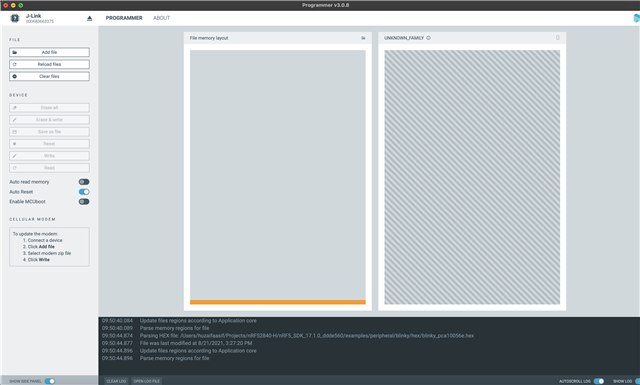

I am setting up Segger Embedded Studio on my M2 Macbook and running in issues.
I downloaded S140 (nRF5_SDK_17.1.0_ddde560) and upon the build, I see the following errors. Does it have to do with the Segger version i have?
12> /Applications/SEGGER Embedded Studio for ARM 7.20/gcc/arm-none-eabi/bin/ld: error: .text section is larger than specified size
12> /Applications/SEGGER Embedded Studio for ARM 7.20/gcc/arm-none-eabi/bin/ld: error: .rodata section is larger than specified size
    I had no issues with programming that hex to my nRF52840 development kit, see pictures:
    How have you connected your development kit to your Mac, are you using the J2 or J3 USB header? Can you plug out anything else that is connected via USB to your Mac and try again. If that doesn't work either, can you try to re install nRF Connect?
