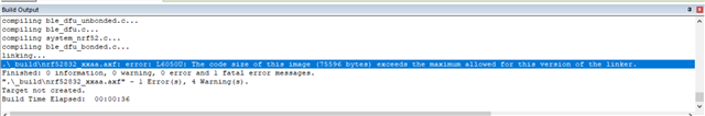

I reinstall μVision V5.34.0.0. μVision V5.34.0.0 shows code size of this image exceeds maximum allowed for this version of linker. But no such before I I reinstall μVision V5.34.0.0. What am I missing?
Hi Snowuyl,
Keil uVision requires a license to be able to use without the code size limitation.
Have you made sure you added your license into the new Keil version ?
You need to click on File ->License Management.
