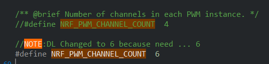

Hi All,

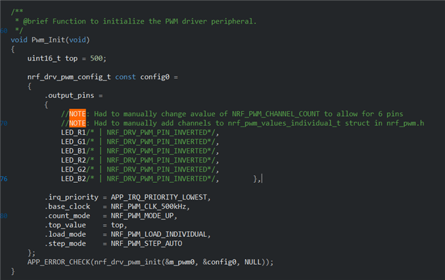

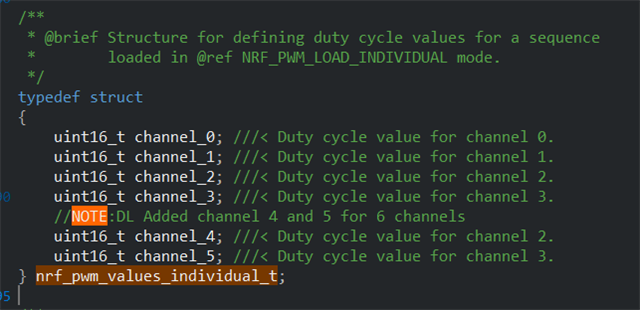

I am in the early development stages of a project using the nRF52832 ble module. I have a custom board already, which has 2 RGB LEDs. By default, it looks like the nrf_drv_pwm driver is configured to have 4 channels. For this project I am looking to use 6 channels. I attempted to add 2 more channels to the driver files as I'll display below. This issue I am having is that the two new channels (channel 4 and channel 5) do not seem to work properly. I very well could be doing something wrong. The other 4 channels operate as expected, but the last 2 channels are always outputting 100% duty cycle immediately after initialization and do not respond to subsequent nrf_drv_pwm_simple_playback() calls to adjust. Thanks for your time!
nrf52832
nRF5_SDK_17.1.0_ddde560
segger 5.70a

nrf_pwm_sequence_t seq;
seq.values.p_individual = &seq_values;
seq.length = NRF_PWM_VALUES_LENGTH(seq_values);
seq.repeats = 0;
seq.end_delay = 0;
(void)nrf_drv_pwm_simple_playback(&m_pwm0, &seq, 1, NRF_DRV_PWM_FLAG_LOOP);
