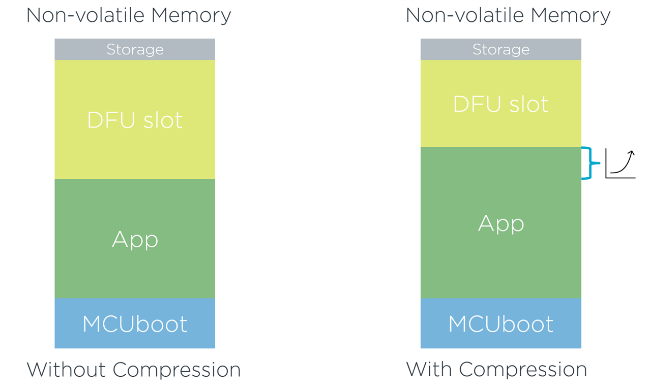

When performing a DFU/FOTA using MCUboot, a DFU partition (also known as slot 1 or the secondary partition) is required to store the newly received image. Before the introduction of the image compression feature, the DFU partition had to be the same size as the application partition (also referred to as slot 0 or the primary partition).
The illustration below depicts a conventional DFU/FOTA process with MCUboot. The DFU partition is highlighted in red, while the application partition is shown in green.
 Dual slot DFU wiith MCUboot
In some situations, this can be an issue if you are constrained on non-volatile memory and would like to have more internal non-volatile memory for your application (for new features, internal storage, etc..)
In that case, we have good news for you in nRF Connect SDK v2.8.0! The symmetric partition size for the DFU partition and the application partition is no longer a requirement when using the new MCUboot image compression feature which allows you to define the DFU partition asymmetrically to the application partition, for example as ~70 % of the size , giving you a free ~30 % non-volatile memory boost that you can use for your application needs.
When this feature is enabled, processes occur both during the build phase and at runtime on the firmware side in MCUboot.
In your development environment, the nRF Compression library is utilized to compress the application image during the build process. The library has support for LZMA (NRF_COMPRESS_LZMA) version 1 and 2, with ARM thumb filter (NRF_COMPRESS_ARM_THUMB). The compression rate varies depending on the application size; larger applications typically achieve higher compression rates. The build system then generates a compressed image.
On the firmware side, when a compressed image is received, MCUboot decompresses the image on RAM after a reset. It ensures that the decompressed size matches the expected size, checks the hash, verifies the image's signature (if enabled) and ensures that the decompressed data is valid,  this is all done before copying the new image to the primary slot.

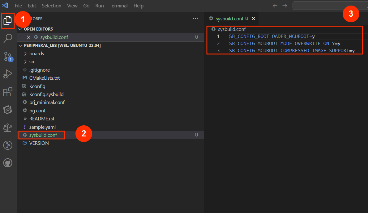

2. Enable MCUboot and the MCUboot compressed image support feature
This is done by adding a Sysbuild configuration file (sysbuild.conf) in the application root directory.
Switch to the Explorer view in VS Code, create a new file called sysbuild.conf, and add the following lines to it.
SB_CONFIG_BOOTLOADER_MCUBOOT=y
SB_CONFIG_MCUBOOT_MODE_OVERWRITE_ONLY=y
SB_CONFIG_MCUBOOT_COMPRESSED_IMAGE_SUPPORT=y
As shown in the screenshot below:

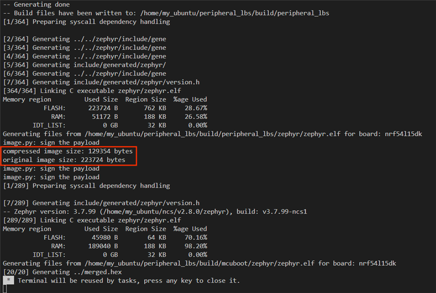

5. Build the application
Switch to the nRF Connect extension; in the APPLICATIONS view, click on Add build configuration and build for the nrf54l15dk/nrf54l15/cpuapp. Leave the default options as they are, which enables Sysbuild, which is needed for this feature.
Examine the build log, a key information to look for here is the compressed image size as shown in the screenshot below:
The output above shows that the build system compressed the application firmware quite well, with a compression percentage of about 42%.

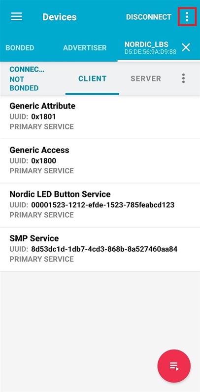

10. Perform FOTA/DFU over Bluetooth LE with the compressed image
On your mobile device, open the nRF Connect for Mobile app; from the SCANNER tab, connect to the device “Nordic_LBS” once the connection is established. Press on the three dots at the top right corner and select Bond.
Bond with BLE device
You will be prompted to enter a passkey.
The passkey will be printed on your serial terminal as a 6-digit number.
Passkey for XX:XX:XX:XX:XX:XX (random): XXXXXX
This helps authenticate and encrypt the connection.

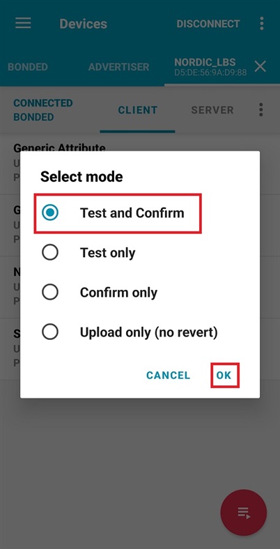

Once the pairing process is completed, Press on the three dots at the top right corner and select DFU. Then select the dfu_application.zip. Finally, select Test and Confirm and press OK.
The transfer process will start and will take a few seconds to finish.
DFU over BLE
The new image will be first uploaded to the DFU slot; once the transfer is complete, an automatic reset is triggered, and MCUboot will start decompressing and validating the new image. Once the validation is completed successfully, MCUboot will move the new decompressed image to the primary slot (non-revertible) and the new image will boot. You should now notice that the new image is running. Notice that LED4 (PCB labeled LED3 on the nRF54L15 DK) represents the run state instead of LED1 (PCB labeled LED0 on the nRF54L15 DK), and the new log message " (Compressed image update running)" is printed on the terminal.

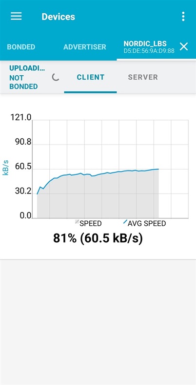

  • Hi Ali,
    Great article, thank you! I'm curious - how is it possible to achieve a data rate of 60.5 kB/s during DFU? I’m using nearly the same settings as you, but my data rates don’t reach that level. Do you think it could be due to the device I'm using for the update (my phone), or might it also be related to the difference between your SoC (nRF54L15) and mine (nRF5340)?
  • Thanks, Ladivin
    The transfer speed is greatly influenced by the central mobile device and its operating system (Android or iOS). Additionally, the speed varies between different Systems on the Chip (SoC) series. For instance, the nRF54L series has twice the processing power of the nRF52 Series.
    I used a Samsung Galaxy S22+ and the nRF54L15 DK.
