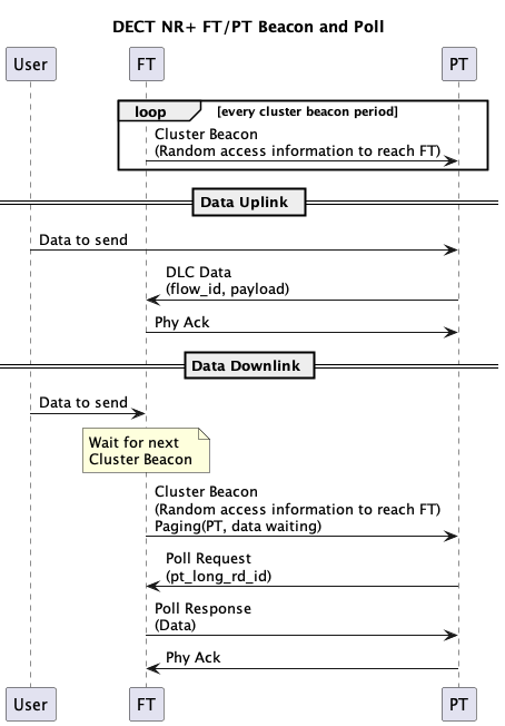

Within the NR+ stack, the MAC layer is responsible for network advertisement, link establishment and device association. It serves as the central network management layer, in addition to handling access control. As of version v2.0.0, the Nordic NR+ firmware supports only a star network topology. The central device, referred to as FT (fixed terminal) in NR+ parlance, advertises the network availability with beacons. Child devices, PT devices (portable terminal) in NR+, find the FT beacons, associate to it and then receive information in those beacons when the FT device is listening for the child’s transmission uplink. In the Nordic implementation, the PT devices are not listening all the time for downlink messages from the FT but instead receive a notification in beacons if a message is buffered for the PT device at the FT. The PT will then poll for the message. Uplink transmissions can be fast, if the FT is listening all the time, but downlink is slower, depending on the beacon advertisement period.
This is shown in the sequence graph below
Sequence graph for uplink and downlink send

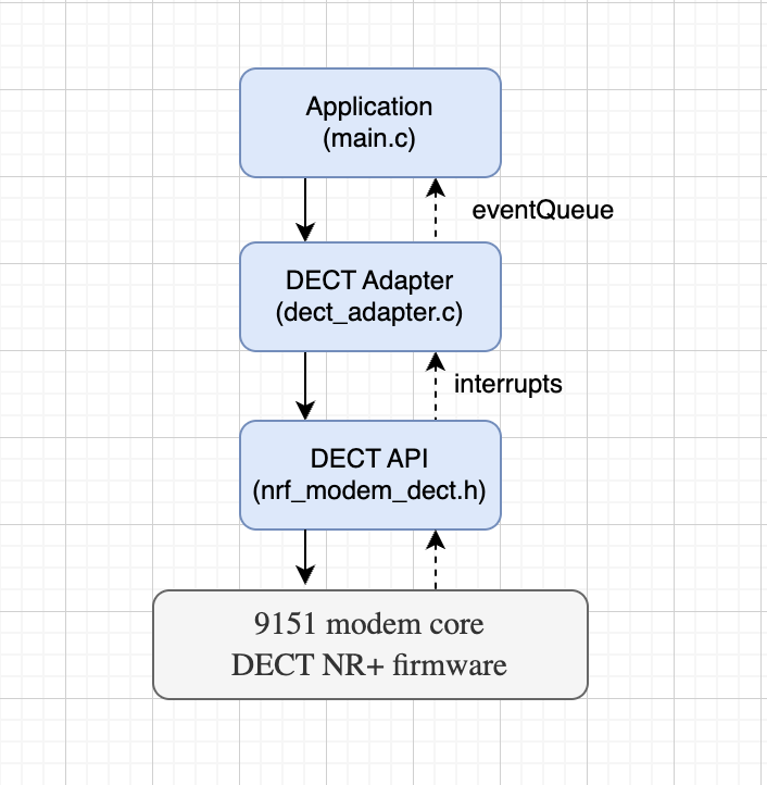

Architecture of the demo software
The demo software started small and simple to show the beacon period impact and power save operation. But there was a surprising amount of parameters and commands needed. It is a shell-controlled application that provides textual feedback on the shell terminal.
The main point for software development is that the DECT API callbacks are in Interrupt service context (ISR), requiring them to be fast non-blocking operations. To facilitate this the software architecture has a DECT Adapter that maps those callbacks to a message queue for application event handlers to process. The Adapter also hides the DECT specific enumerations from the application.
The software architecture of this demo is shown in the figure below
Software architecture
The application handles shell commands, controls the operation and processes the resulting events. There are callbacks on operation completion and application events for data processing notifications from the adapter. The asynchronous operation completion is handled in the prepare_wait, wait_for_prepared_operation and complete_wait functions and semaphores.
The DECT Adapter’s main function is to map the DECT API callbacks into message queue events. This separation prevents dependency leakage and (hopefully) simplifies maintenance.

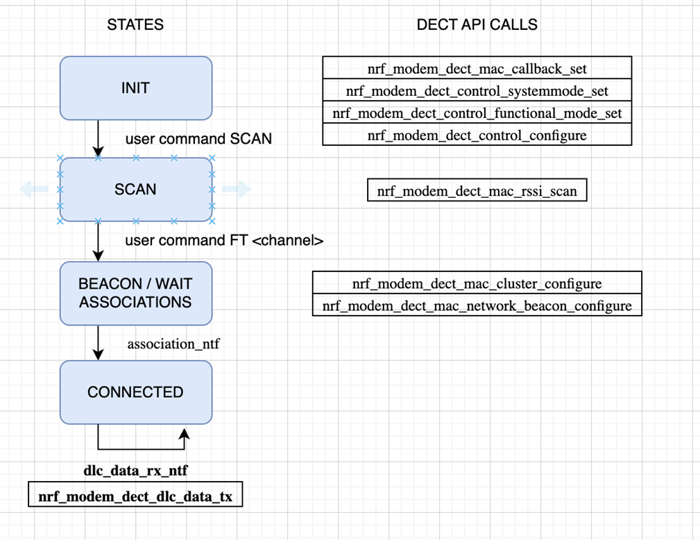

It is a bit scary looking (hence our approach with AI Agents) so let’s define the minimal flow for clarity.
The control flow in this demo for the FT device is shown in the figure below, showing the functions called and the state transition events. Association acceptance is automatic if there is memory left in the modem.
FT flow

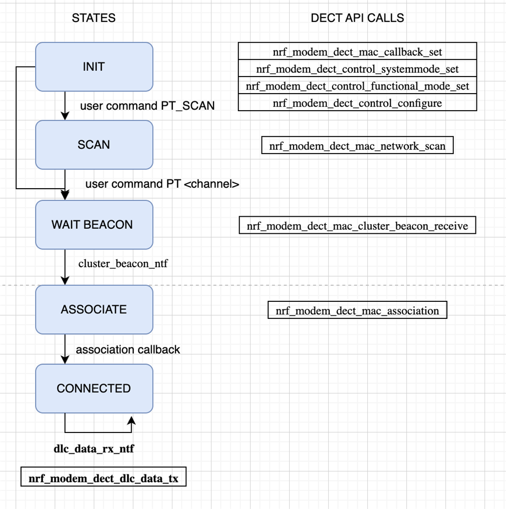

The PT flow is shown in the figure below
PT flow
There is an optional network scan state, listing found networks (and cluster beacons) on all channels. This was kept for later use of the code. The key thing is to start the beacon receive from the FT and then associate to the FT device. A beacon must be received for the modem to have the radio parameters for how to contact the FT device.

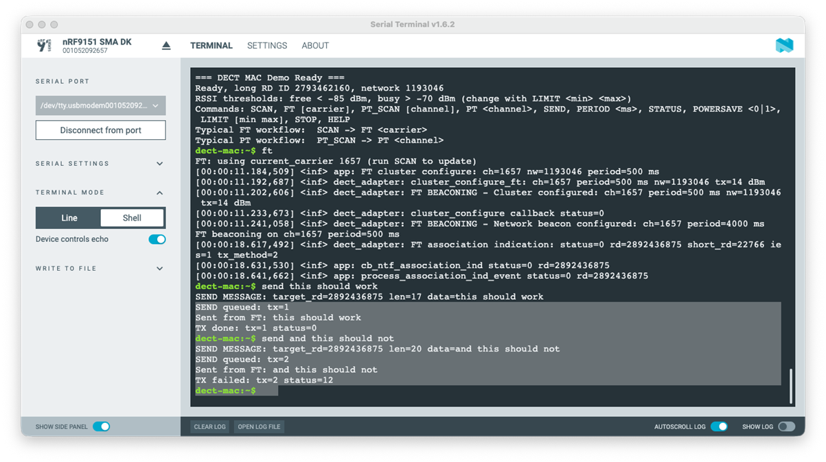

The image below shows a common failure mode. FT tried to send data to the PT, but the PT has dropped out of radio the network so the sending fails.
Note that the timeouts are long, NRF_MODEM_DECT_DLC_SDU_LIFETIME_60_S, those can be controlled in the DECT adapter’s custer_configure_ft and association_request functions with thedlc_sdu_lifetime parameter.
FT showing failed transmission

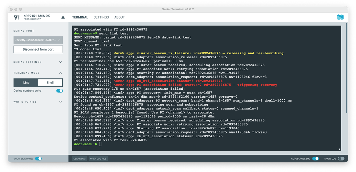

The FT device is sticky to stay in the beaconing state and accept associations. On the PT side there is fallback (a worker) that is kicked off if there are multiple DLC TX errors, association release or loss of beacon reception. It stops possible ongoing work, re-initializes and associates on the same channel – the assumption is that the FT stays there. This is rudimentary and very poorly tested too!
This re-subscribe is shown in the image below. The key is to check the callbacks status values, and for example the notification cluster_beacon_rx_failure_ntf which signals that the FT signal has not been seen. How soon the notification is fired can be configured in nrf_modem_dect_mac_association_params.
PT recovery from lost beacons

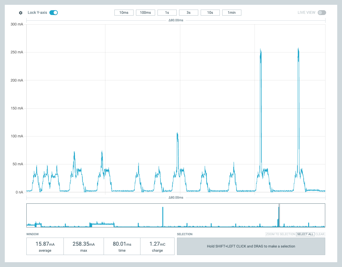

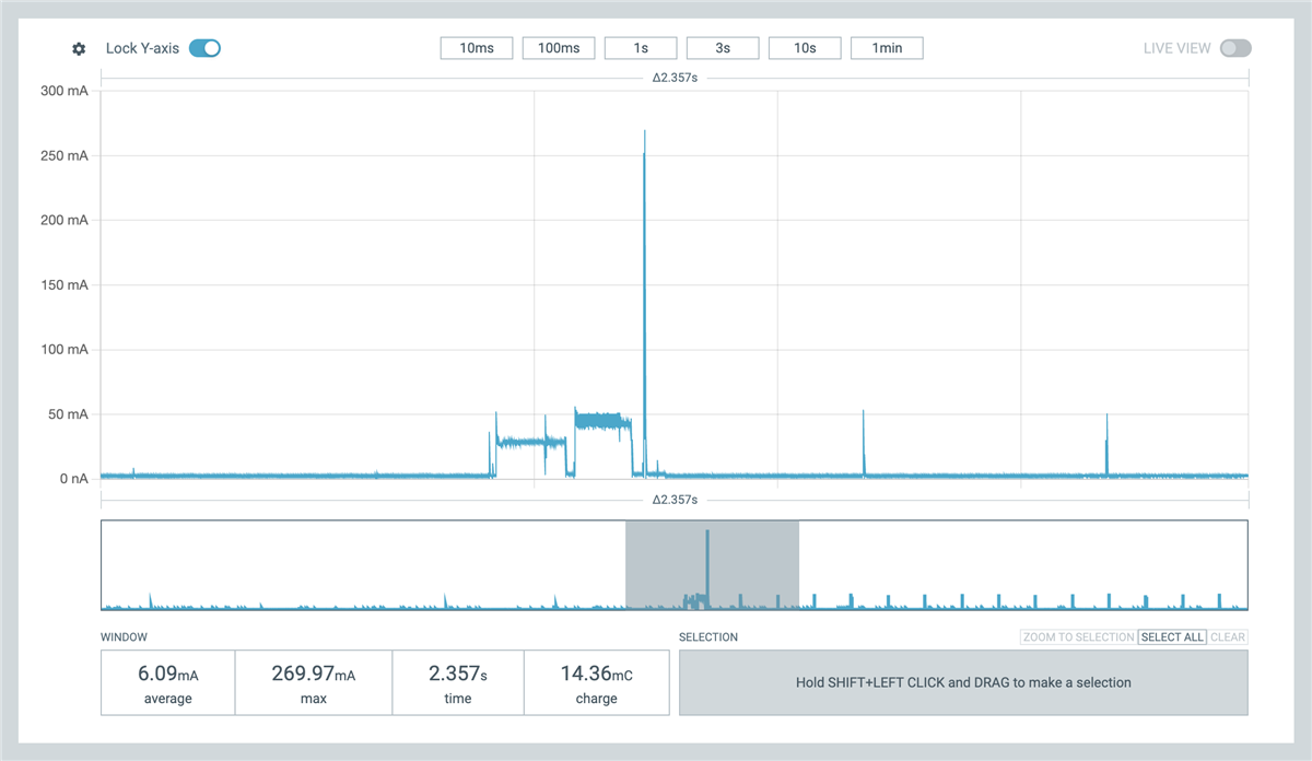

Basic operation, no power save
The image below shows the power consumption of the PT device without power save for network scan and association – the high peak. Scan is active listening, at around 50mA power consumption level. Then the association is done, TX peak at 260mA followed by a short response reception window at 50mA. Since this is the first communication, the TX power is not adjusted. After the association period, reception peaks can be seen. These are the beacon receptions from the
FT.
Scan and association, no power save

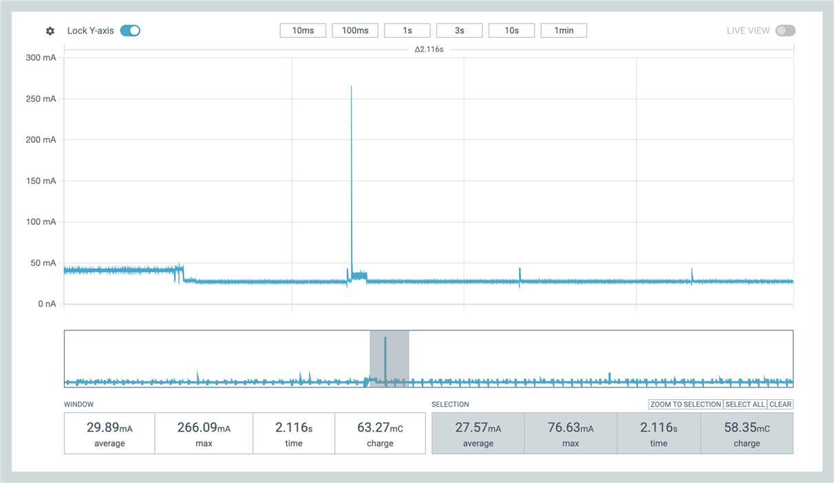

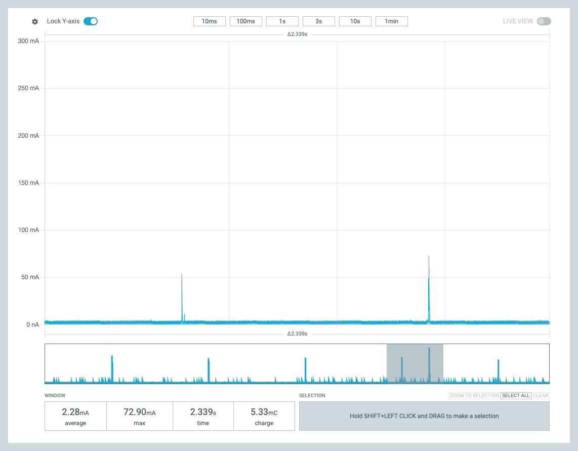

Power save features in practice
The image below shows similar a association with power save enabled. There is the scan window at around 50mA (and before that the processing of the user command). Association TX peak is once again around 260 mA.
PT association with power save

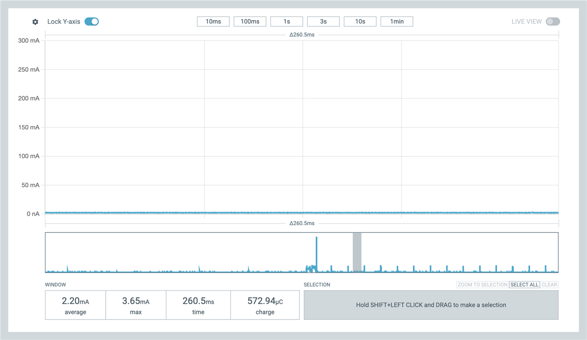

But after this, the power usage drops significantly, the radio is shut down and power consumption is around 2.2mA as shown in the image below. The application does not implement any power save optimizations and so the application core is running, meaning further power savings are possible. The periodic spikes are once again the beacon reception windows when the radio is powered back on for reception.
Idle in power save mode

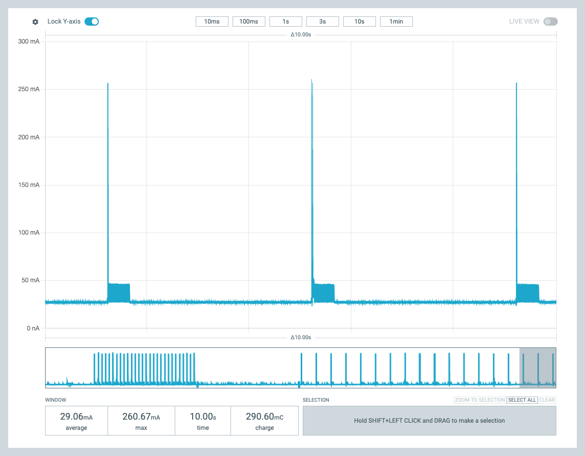

Once in the association state, the TX power can be adjusted. As shown in the image below, the TX peak power usage is controlled, and in this instance is around 70mA. The 50mA peak earlier is the beacon reception window. This TX power adjustment is done based on the nrf_modem_dect_control_configure_params params.expected_mcs1_rx_rssi_level parameter.
The power levels are tracked in association based on reported transmission power in the NR+ PHY header and on the measured reception power. This is then used to calculate the TX power needed to meet the communicated expected level for reception.
Adjusted send TX power in association
