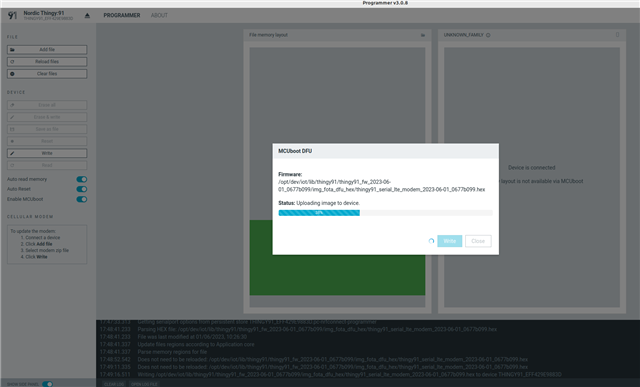

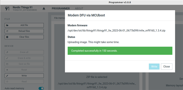

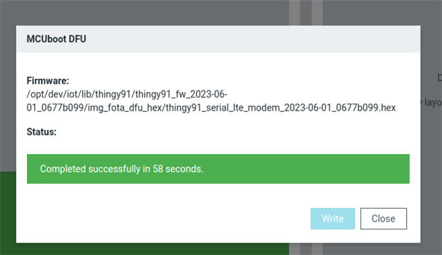

I had already downloaded the current firmware+applications version (thingy91---hardware-files-1_6_0.zip) and I was able to upload the firmware and the thingy91_serial_lte_modem_2023-06-01_0677b099.hex applicatoioon according to the video instructions (with MCUboot mode enabled).

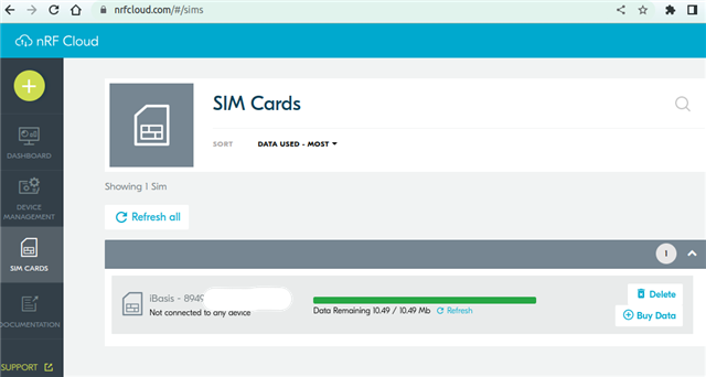

On the first page of the wizard i entered the required data and the check seemingly passed. I'm not sure how relevant this page is (it shows that there is no iBASIS coverage here in Bulgaria) but the activation passed and later I could see the card listed in the "SIM Cards" tab.

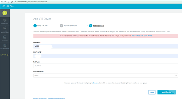

On the third page after filling in the required fields clicking the Add Device presented me with error with code 40412 and link to this relevant page for troubleshooting.
The problem is that after this step the LEDs stopped and the device remained dark. I tried the suggested solutions but no matter what cable I use the device can not be seen anymore on any linked computer and can't be seen in the Select Device menus in any of the applications on any of the computers that it was successfully linked to previously.
A this point my question is: should and can I make some sort of a factory reset and how?
