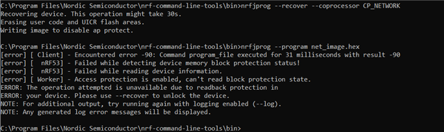

    Only way I succesfully flashed the chip was using the merged image and the Programmer v3.0.8.
    When I use the nrfjprog for flashing the image for net core, I get following errors:
    steps executed:
    nrfjprog --recover --coprocessor CP_NETWORK
    nrfjprog --program

    Are you trying to program the net core or the app core? Here you are recovering the net core, but attempting to program the app core (which is the default when no coprocessor is specified). Also, note that you can recover and program in one go.
    vojtech265 said:
    steps executed:
    nrfjprog --program
    Regarding the error you got from your script, I wonder if this is because of a mismatch between the address range in the hex and the core you are connected to. If the hex is for the network core, you need to select it, typically with a sequence like you see in this script (where the app core is explicitly used, but you can use the same approach for the net core by replacing CP_APPLICATION with CP_NETWORK.

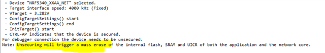

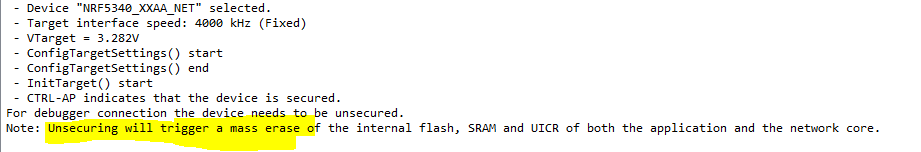

    However, the problem with connecting to the device still occures in J-Flash:
    1. I succesfully flashed the chip with the script above
    2. I choose nrf5340_xxaa_net, connect to the device and still getting this message:
    But readback with the nrf Connect Programmer works perfectly fine.
    The problem is gone, when I manually flash merged image via nrf Connect Programmer:
    1. I manually flash the chip with the nrf Connect Programmer
    2. In J-Flash I choose nrf5340_xxaa_net, connect to the device succesfully connect and can readback
    Is there anything in my script missing? Where could be that problem?
    There is one fundamental difference when doing a recover from the python API and the command line, and that is that when doing recover from the command line, a special hex file is written that enables debugger access in the UICR and also runtime (see CTRL-AP - Control access port for details on how the mechanism works in the SoC).
    As that does not happen automatically, you now need to write to the APPROTECT register in UICR from your script in order to keep debugger access alive. This needs to be done both for the app and net core, and you need to write the magic word 0x50FA50FA. The firmware you program must also enable debugger access, but that is the default in the nRF Connect SDK, and as this works when you program from the command line, that should be in order.

    vojtech265 said:
    Is this special hexfile available?
    No, it is part of the nrfjprog binary. But you can build a nRF Connect SDK project yourself and flash it and it would do the same by default, which is to enable debugger access.
    vojtech265 said:
    then if I connect to the device it is protected. Is something what I am missing?
    Yes, that is expected. In order to access the debugger interface either an erase all operation has to be performed in that debug session (which is how you can recover a device and program and empty device), or what is relevant in this case: Both have the magic word in APPROTECT register in UICR and the running firmware must write to APPROTECT.DISABLE. If you have not flashed any firmware, that does not happen, and therefor debugger access is blocked.
    Summing up: To unlock the debug port, you you must both have the magic word in UICR.APPROTECT and firmware must write the magic word to APPROTECT.DISABLE on every boot. Both this happens automatically with nrfjprog --recover from the command line. If you use other tools, you need to handle it yourself, which means writing to UICR and programming your firmware).
    PS: To build a firmware that does not open the debugger, you need to enable  NRF_APPROTECT_LOCK and CONFIG_NRF_SECURE_APPROTECT_LOCK if you want that at a later stage.
