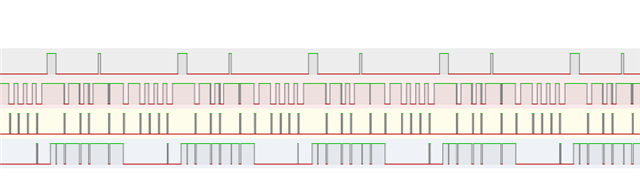

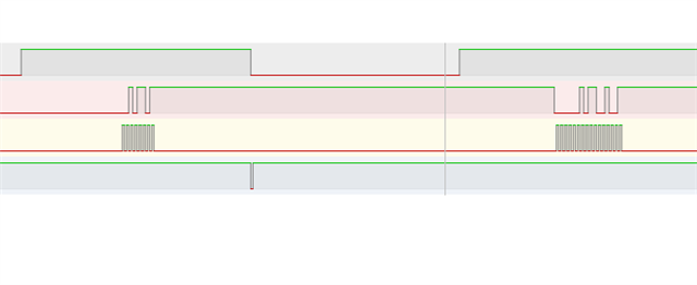

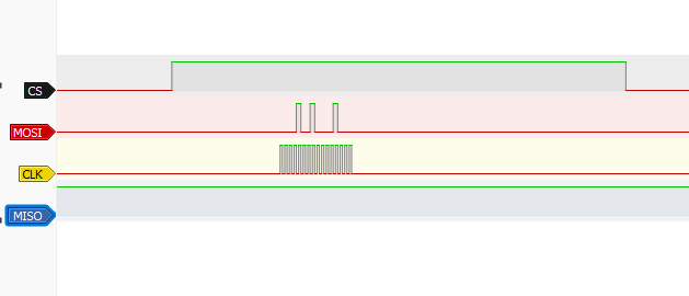

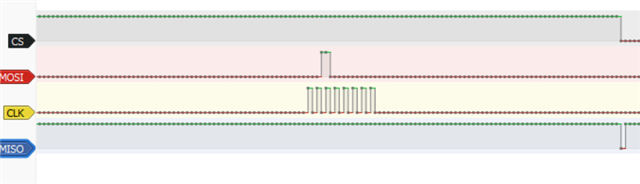

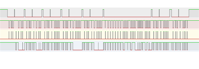

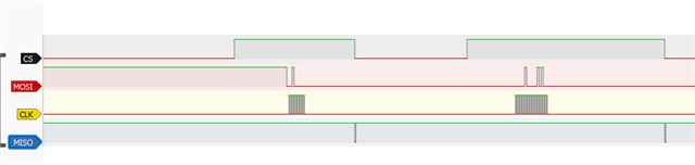

    The spi instance is "initialized," but I can't use the spi port as a sensor.
    From what i can read from your post, this is the issue, right?
    Can you give some more details on this?
    Sigurd Hellesvik
  • Yes, it is.
    I see the log of successful initialization of the spi@a000 instance - but I do not see any visible connection. When I tried to listen to the signals with the logic analyzer - I saw some activity, with some responses from the MISO - but it didn't initialize the device's setup correctly.
  • There is a known bug with SPI communication. Before R/W, you should LSH the address bytes to get the correct address. Also, in reading - you should start reading the buffer from the 3rd byte (index 2) and not from the initial. Length in reading should be your_desired_lenght+2.
    Thank you for your input but I am quite not able to follow it as I am new to Zephyr & SPI protocol.
    I ran AD5940_SPI code from Analog Devices GitHub AD5940_SPI_Github.
    This is the output i got.
    22:33:04.553 -> Read ADIID register, got: 0x4144
    22:33:04.553 -> Read register test pass
    22:33:04.891 -> Read/Write has been done 1000 times, latest data is 0xf40f548e
    22:33:05.212 -> Read/Write has been done 2000 times, latest data is 0x7aeaacba
    22:33:05.541 -> Read/Write has been done 3000 times, latest data is 0x5b509ed3
    22:33:05.907 -> Read/Write has been done 4000 times, latest data is 0x521fb044
    22:33:06.232 -> Read/Write has been done 5000 times, latest data is 0x7e162e25
    22:33:06.594 -> Read/Write has been done 6000 times, latest data is 0xdbf72575
    22:33:06.928 -> Read/Write has been done 7000 times, latest data is 0xcf87c206
    22:33:07.286 -> Read/Write has been done 8000 times, latest data is 0x3c631b0d
    22:33:07.606 -> Read/Write has been done 9000 times, latest data is 0x71bb3463
    22:33:07.964 -> Read/Write has been done 10000 times, latest data is 0xebdebb73
    22:33:07.964 -> SPI read/write test completed
    I also have AD5940 Evaluation board and ran the same code to cross check the results.
    This is the output from AD5940 Evaluation board
    This AD594x!
    Note: Current Silicon is S2
    AD5940LIB Version:v0.2.1
    Read/Write has been done 1000 times, latest data is 0x831b4bd2
    Read/Write has been done 2000 times, latest data is 0x3bb3348a
    Read/Write has been done 3000 times, latest data is 0xf24b4342
    Read/Write has been done 4000 times, latest data is 0x26e3f7fa
    Read/Write has been done 5000 times, latest data is 0x597bd2b2
    Read/Write has been done 6000 times, latest data is 0x0a13536a
    Read/Write has been done 7000 times, latest data is 0xb8abfa22
    Read/Write has been done 8000 times, latest data is 0xe54346da
    Read/Write has been done 9000 times, latest data is 0x0fdbb992
    Read/Write has been done 10000 times, latest data is 0xb873d24a
    As you can see, Read and Write is happening but at different registers.
    Because of this when I try to run other application codes(such as amperometry), I am not getting results
    I have attached my NRF_Port.c and main.c
