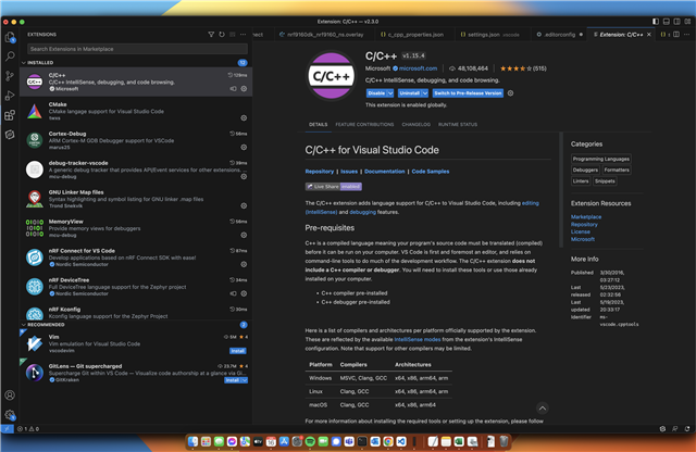

I first installed the command line tools (nrfjprog + JLink ARM), followed by nRF Connect for Desktop v4.1.1. I then installed nRF Connect SDK v2.3.0 using Toolchain Manager v1.2.4 on two computers: 1. Apple x86, macOS 11.x and 2. Apple M1, macOS 13.x. I let Toolchain Manager install nRF Connect extension v2023.4.179 for VS Code (v1.78.2 Universal). On both computers I had some issues:
  1. I manually installed the C/C++ extension v1.15.4 for Apple M1; this required deleting the extension folder for the non-universal version that had been installed by Toolchain Manager
  2. From Toolchain Manager I had to run the option "Generate environment script" and run this in the macOS Terminal with the sh command from inside the workspace repo folder
  3. I edited the include and browse paths in c_cpp_settings.json, explicitly adding the include path for NRFXLIB NRF_MODEM
  4. I edited the include path in nrf connect extension (partly because it does not recognize all legal VS Code syntax from c_cpp_settings.json)
  5. I added "NRF9160_XXAA" in the "defines" section of c_cpp_settings.json
  6. I installed nrfjprog version 10.21.0 external for macOS 13.x & version 10.15.x for macOS 11
  7. I installed JLinkARM.dll v7.88b (Universal) for all versions of macOS
I have some remaining issues:
  1. The west command runs successfully after a build configuration, but west is not recognized in the macOS or VS Code terminals
  2. newlib.h refers to picolibc.h, which is not included in NCS 2.3.0 - everything builds OK, but it causes distracting red squiggles in VS Code
  3. Flashing larger merged hex files to the nRF9160 DK fails frequently with varying errors
I know of other users who have encountered similar issues with macOS. Does anyone have a template, or link(s) to documentation, showing the required settings ("defines", include & browse paths, nRF Connect extension, project workspace and macOS $PATH)? Thanks,

  • Hello Paul,
    Are you able to provide some logs for us? Can you please attach the output from nRF Connect: Generate Support Information (in VS Code)?

  • Hi Øyvid,
    nRF Connect Support Information and the $PATH variable are below. Running pip3 show -f west in the macOS Terminal gives a warning: Package not found. Also, I notice that nrfutil is "not found" (see below).
    I added /opt/nordic/ncs/toolchains/v2.3.0/bin to $PATH. west is now recognized in macOS Terminal from my home directory with west --version (not show), but west --version is not recognized in VS Code Terminal.

  • Hi Øyvind,
    Would it be possible to share the support log for nRF Connect extension and snippets of the c_cpp_settings.json and a workspace settings JSON from your Apple M2 machine?

  • Hi Paul, sorry the late reply.
    Here is the support log from my Macbook Air M2
    The closest on my side is modules/lib/loramac-node/.vscode/c_cpp_properties.json
        "configurations": [
                "name": "ARM",
                "compileCommands": "${workspaceRoot}/build/compile_commands.json",
                "intelliSenseMode": "clang-x64",
                "browse": {
                    "path": [
                        "${workspaceFolder}"
                "cStandard": "c11",
                "cppStandard": "c++17",
                "configurationProvider": "ms-vscode.cmake-tools"
        "version": 4
    ~/Library/Application Support/Code/User/settings.json
        "nrf-connect.welcome.showOnStartup": true,
        "nrf-connect.enableTelemetry": true,
        "nrf-connect.topdir": "${nrf-connect.sdk:2.3.0}",
        "nrf-connect.toolchain.path": "${nrf-connect.toolchain:2.3.0}",
        "nrf-connect.activeAppFollowActiveEditor": false,
        "nrf-connect.boardRoots": [
            "Support/<removed>/boards"
    Let me know what more you would like me to provide
  • Hi Øyvind,
    That's very helpful, thanks. It's nice how you can type "nrf-.." in the workspace settings file and VS Code will prompt for options - very useful. There are only 3 significant differences between our setups. My c_cpp_settings.json has:
    1. "configurations": configurationProvider: "nrf-connect"
    2. "intelliSenseMode": "macos-clang-arm64
    3. "defines": [ "NRF9160_XXAA" ]
    I have VS Code 1.79 (you have 1.78), and that's where on Apple M1/M2 it started to complain about clang-x64, which necessitated deleting the C/C++ extension folder and installing the ARM version. "NRF9160_XXAA" seemed to be necessary to resolve NRF driver include paths. I asked ChatGPT, "What does configurationProvider in visual studio code's configurations in c_cpp_settings.json do?" The answer is interesting.
    There's a lot going on under the hood. I appreciate that you guys are trying to keep up with 3 platforms and hide the details in Toolchain Manager. My "3 remianing issues", detailed in the original post, are still present, but I can work around them.
    Thanks again for your help,
    Paul
