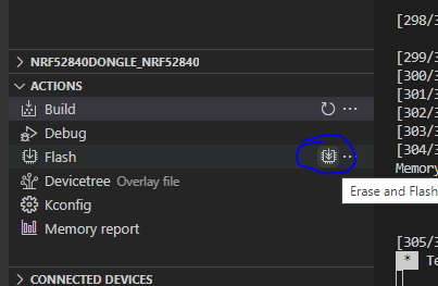

    Another option is to do a full erase of the chip on both side. Then they will start fresh. You can do a full erase by using nrfjprog.exe --eraseall.
    Or if you use Visual Studio Code, you click on double arrows button when flashing:

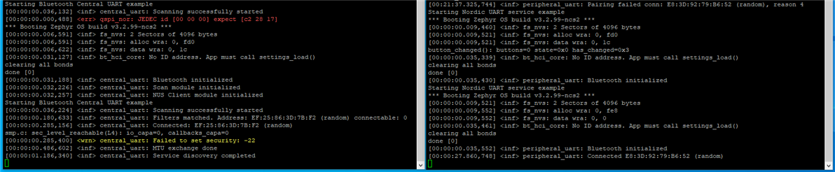

    I have tried your suggestions (erase and unpair() ), but both fail. Please see the attached picture.
    I was able to trace the -22 error on the central_uart example back to not having the .passkey_display nor
    .passkey_confirm callback functions. This seems to make sense because in connected() we are going to
    err = bt_conn_set_security(conn, BT_SECURITY_L2); So we need a display and a keyboard to show security code and confirm the verification code on the central as well? Please correct me if I'm missing something.

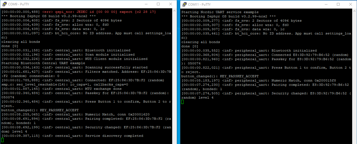

    After this we also need something to push a button, so the button_changed() and num_comp_reply() functions
    from the peripheral_uart example ported towards the central_uart. And now it works and we get the following result:

    CONFIG_BT_SMP_SC_ONLY=y
    CONFIG_BT_TINYCRYPT_ECC=y
    Arno

    I have 2 more additional questions.
    1) Now I'm able to pair the 2 devices. Now I was expecting that after switch on the devices (reboot), that the pairing would be erased by
    bt_unpair(BT_ID_DEFAULT, BT_ADDR_LE_ANY);
    However the devices stay paired as you can see in the picture. What I'm I forgetting?
    2) We are asking for security level 2 with
    However in the picture is indicated "Security changed: EF:25:86:3D:7B:F2 (random) level 4", where is this level 4 coming from? Maybe from the options: CONFIG_BT_SMP_SC_ONLY=y or maybe does Bluetooth LE does not permit level 2 nor level 3?
    Any help appreciated.
    Arno
  • Hi Arno,
    Could you please double check if CONFIG_BT_NUS_AUTHEN is set to y ?
    If it's set then the NUS service will require the connection to be at security level 3 or 4. Security level 2 (Just Work) will not work.
    You can have a look here at this course to see the explanation on different security levels: https://academy.nordicsemi.com/topic/security-models/
    If you have passkey and LE Secure Connection, you will get security level 4, even if you only ask for security level 2 (it will try to get the highest security level).
    However, if on one peer you don't define the callback for display or keyboard or confirm you will get only Just Work (level 2) .
    So in theory it should still work with L2 if you don't have these callback. I'm not so sure why it didn't work for you.
    You may want to try capture a sniffer trace. It will reveal how the communication is over the air and which side of the connection require higher security.
    For your information, I'm following exactly the central_uart and periheral_uart examples. In both examples
    CONFIG_BT_NUS_AUTHEN is not set the the prj.conf. So it remains a mystery why security level 4 comes out?
    Arno
  • Hi Arno,
    Level 4 will automatically achieved if you have LESC and have MITM protection (passkey for example).
    What I'm not so sure about is why it's failed when you don't have display callback for passkey and you only request L2.
