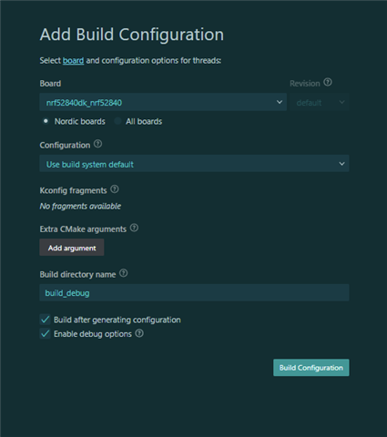

    When you build a Zephyr application without any debug options, the default config is for GCC to optimize your code for speed (with -O3, I think). If you want to optimize for debuggability, you
    can add this Kconfig option:
    CONFIG_DEBUG_OPTIMIZATIONS=y
    (There's also CONFIG_NO_OPTIMIZATIONS which some are tempted to use, but I just learned from this little comment that CONFIG_DEBUG_OPTIMIZATIONS might actually produce faster code since it tries some -O1 optimizations.)
    Assuming you're using the VS Code extension, CONFIG_DEBUG_OPTIMIZATIONS is enabled automatically when you select the "Enable debug options" option when adding a new build configuration. So I recommend just adding a build configuration for debugging:
    Optimizing for debugging can make your code larger, so if you're unlucky, it might not fit in RAM/Flash anymore. But if it fits, I think addr2line should now work correctly.
    If it doesn't fit, you could perhaps optimize only part of your application, as described here:  Disable optimization of part of the code through CMAKE But I haven't tried that myself yet.
