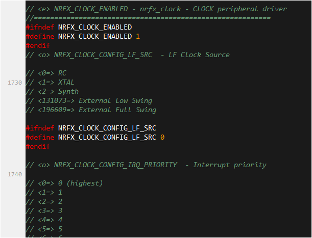

    I did a similar test with my nRF52 development kit, I cut the solder bridges that connect the LFCLK crystal, and then I tried advertising with the ble_app_blinky project. As expected it didn't work, after that I tried changed the sdk_config.h project by:
    #ifndef NRF_SDH_CLOCK_LF_SRC
    #define NRF_SDH_CLOCK_LF_SRC 0
    #ifndef NRF_SDH_CLOCK_LF_RC_CTIV
    #define NRF_SDH_CLOCK_LF_RC_CTIV 16
    #ifndef NRF_SDH_CLOCK_LF_RC_TEMP_CTIV
    #define NRF_SDH_CLOCK_LF_RC_TEMP_CTIV 2
    #ifndef NRF_SDH_CLOCK_LF_ACCURACY
    #define NRF_SDH_CLOCK_LF_ACCURACY 1
    I then reflashed the example and saw that it was advertising sucessfully.
    Note that also need to change  NRFX_CLOCK_CONFIG_LF_SRC to RC clock source if it isn't already.
